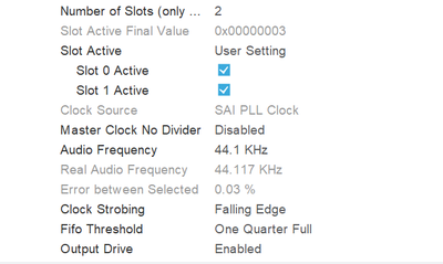

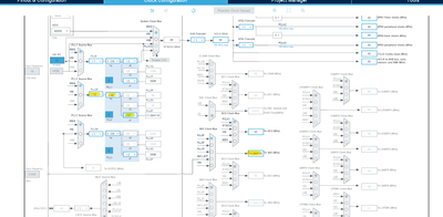

Hi @Saket_Om
Thanks for your response. My clock configuration is shown in the image, and I’ve attached the IOC file for reference. Appreciate your support!
Thanks,
Jinal

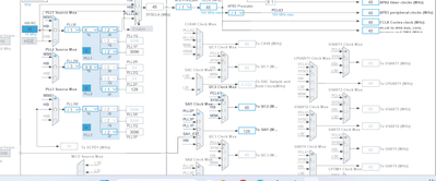

Hello @Jinal
Could you try with the flowing config please.
In this config the SAI kernel clock is around 11.294 which is nearly multiple of 44.1 Khz.
Saket_Om
Hi @Saket_Om
Thanks for response,
I configured the SAI kernel clock as per your suggestion, and the audio output is now slightly clearer.
When we play a mono-converted audio file using the existing configuration, the sound quality has improved — it’s more audible, though still not perfect.
