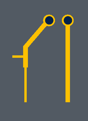

1.1 Impedance mismatches
These occur when the impedance between different parts of the transmission channel is not properly matched, causing signal reflections that degrade the signal quality:
- Changes in trace dimensions/geometry
- Improper terminations/unterminated stubs
- Via characteristics (hole size, pad sizes, etc.)
- Discontinuities/return path
- Variations in board materials
Figure 1. PCB traces

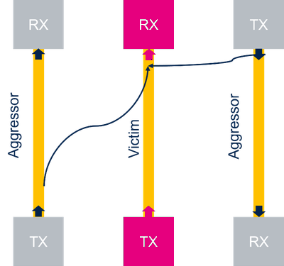

1.2 Crosstalk
This is the unwanted coupling of signals between adjacent conductors or traces in a circuit, where the signal transmitted on one channel (known as the aggressor) induces an undesired signal in a neighboring channel (known as the victim). This phenomenon occurs primarily due to the electromagnetic interactions between the conductors, specifically through mutual inductance and mutual capacitance.
Mutual inductance causes crosstalk when a changing current in the aggressor trace generates a magnetic field that induces a voltage in the victim trace.
Mutual capacitance leads to crosstalk when the electric field between adjacent conductors allows a portion of the signal’s voltage to couple across, transferring energy from the aggressor to the victim.
Crosstalk is categorized into two types based on where the interference is observed relative to the aggressor signal.
Near-end crosstalk (NEXT): The interference appears at the receiving end of the victim trace closest to the aggressor’s transmitter.
Far-end crosstalk (FEXT): The interference appears at the far end of the victim trace, away from the aggressor’s transmitter.
The severity of crosstalk increases with faster signal rise times because rapid voltage changes generate stronger electromagnetic fields, which more readily couple into adjacent traces.
Figure 2. Signals crosstalk

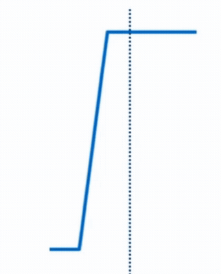

1.4 Jitter
A jitter is the variation or deviation in the timing of a digital signal’s transitions relative to their ideal positions. In digital communication systems, signals are sampled at precise, predefined bit times to interpret the transmitted data correctly. For accurate data recovery, signal transitions (the changes from logical 0 to 1 or vice versa) must occur within specific timing windows between these sample points.
Figure 4. Jitter
When jitter is present, these transitions shift in time, causing the signal to arrive either earlier or later than expected. This timing variation can lead to several issues:
Incorrect sampling: If a signal transition occurs too close to or during the sampling instant, the receiver may sample an undefined or intermediate voltage level rather than a clear logical ‘0’ or ‘1’.
Bit errors: Such incorrect sampling results in bit errors, where the received data differs from the transmitted data, degrading communication reliability.
Timing uncertainty: Jitter introduces uncertainty in the timing margin, reducing the tolerance for noise and other impairments.
