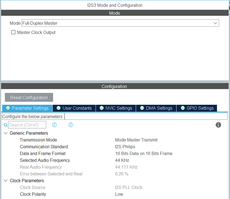

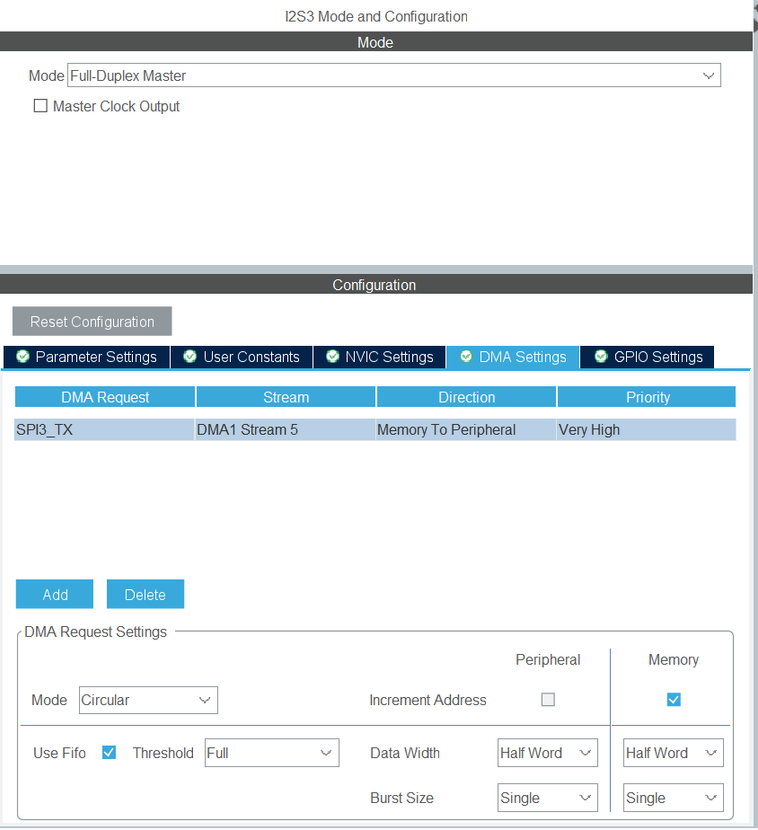

I am doing an stm32 project with STM32F407VET6 MCU, I want to implement a music player that can read a list of wav files from sd card and stream the music data to a external DAC chip (PCM5012a) using double buffering apporach. I have configured SDIO and FATFS with DMA enabled for perfrming the sd card interfacing and read files, which should be working normally. But the main problem is comming from I2S3 with DMA, as it doesnt continue stream subsequent audio chunks after the 1st one. Here is my i2s3 ioc configurations:

With my understanding, Start_I2S_DMA() should trigger I2S3's transmission of streaming PCM data to the DAC chip, and it should repeatedly invoke callbacks to HAL_I2S_TxHalfCpltCallback and HAL_I2S_TxCpltCallback, and the audio buffer should be filled as the MCU f_reads the current wav file.
But with only one single audio chunk being played, it seem to me that the callbacks are not invoked repeatedly.
Has anoye know how to solve/debug the issue? Thanks!
