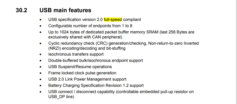

My device is STM32F072,and connect to Host. I want to identify the Host support speed( Full-Speed or High-Speed ).
Is there any register/fuction ,can detect Host is Full-Speed or High-Speed

Documentation mentioned only about full-speed for this board:
STM32F0x1/STM32F0x2/STM32F0x8 advanced Arm<Sup>®</Sup>-based 32-bit MCUs - Reference manual

I mean ....,there is any way for stm32f072 to recognize that whether the host supports High-Speed mode
waclawek.jan
No.
