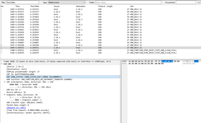

I'm creating a new USB device with a custom USB class on an STM32F779NIH.  We have previously developed a fully operational device doing the same thing with USB full speed, now we're trying to do the same with USB highspeed using an external ULPI. I'm reasonably certain the issue is firmware not hardware.
The overall scheme is using bulk transfers to send data out at a periodic rate, say 1ms for example, so 8 microframes will elapse before data is sent back to a read request. The PC read function will blocks until it receives that data which creates a timing loop that turns out is quite resilient compared to Windows timers. Anyway, back to this device, when I run my user application, it will generate a read request for which the device will return a response after 1ms with a set of data which is correctly decoded.  This is repeated 8 times, but on the 8th packet, my device returns no data and a status of 0xC0000011 (which is a USBD_STATUS_XACT_ERROR) according to WireShark:
According to page 34 of this PDF: https://www.intel.com/content/dam/www/public/us/en/documents/technical-specifications/ehci-specification-for-usb.pdf it may mean:
Set to a one by the Host Controller during status update in the case where the host did not receive a valid
response from the device (Timeout, CRC, Bad PID, etc.). This bit may only be set for isochronous IN transactions.
However, 1) this definition is for isochronous, 2, the bit position doesn't align with the data in the image above, and 3) as far as I can tell, this is being set somewhere in the device firmware rather than from the host. This is the first time I'm using a ULPI, so I'm uncertain if perhaps it is generating this directly. I'm am, however, fairly certain this isn't a timeout issue (at least from the device side) as the PC blocks until it receives the data.  I can run the device as fast as one packet per 125us, or slow it down to slow it down to 2ms and it always throws the error on the 8th packet.

I made some further progress with this and now I can confidently say the issue is firmware, not hardware. I'm mostly detailing this for the other people I've seen that have run into this error message, but I do still have a question at the bottom.  :)
I know in USB that everything is driven from the host.  For a device to transmit to the host, it first must first wait for a read packet to come in. The goal of our project is to stream real-time data to the PC so what I was attempting to do above was send out data at a regular interval by using a timer to take a snapshot of our data and putting it into a byte array and then passing to our transmit function:
USBD_StatusTypeDef  USBD_CUSTOM_TransmitD2H(USBD_HandleTypeDef *pdev, uint8_t* buf, uint16_t length, uint8_t interface)
  USBD_StatusTypeDef usb_status;
  pdev->ep_in[USB_I0_CUSTOM_EPD2H_ADDR & 0xFU].total_length = length;
  if (interface == 0)
    usb_status = USBD_LL_Transmit(pdev, USB_I0_CUSTOM_EPD2H_ADDR, buf, length);
  else
    // handle other interfaces here
  return usb_status;
 Digging further down into USBD_LL_Transmit to HAL_PCD_EP_Transmit to USB_EPStartXfer to USB_WritePacket it appears it directly copies the data into the Tx FIFO.  However, all these functions always return HAL_OK and I don't see anything along the way that checks that the Tx FIFO actually has space to receive this. Until I dug into this, I had assumed if there was a failure, these functions would have made some indication so my code above USBD_CUSTOM_TransmitD2H would pause sending until space was available again.
As a temporary hack, I set a flag in HAL_PCD_IRQHandler (stm32f7xx_hal_pcd.c) on the transfer completed interrupt just before HAL_PCD_DataInStageCallback(hpcd, (uint8_t)epnum) and then my transmit function checks that flag.  If it is true then I assume my last packet went out already so it's safe to send another (in which case I set the flag to false again).  Since this is handling all the transmissions on my IN endpoint it is probably also getting set during the enumeration so when I run my PC code, it still gives me a single bus stall and reset, but after that first reset of the bus I can then run continuously for hundreds of thousands of packets with a packet going out on almost every microframe when I run the user code as a high-priority process on Windows. As a normal-priority process there are frequent millisecond gaps in the transmission of data, but it correctly throttles the transmission of data and no longer throws errors.
So in hindsight, I think (and someone please correct me if I'm wrong) that the error I saw on WireShark was effectively telling the PC that the FIFO was full. Normally if the PC was first requesting the data then it would be a failure on the PC side to read the data after it had requested it, but since this was more of a "push" approach, the PC simply wasn't keeping up and particularly when running as a normal-priority process a single delay from the OS running another process caused the FIFO to overfill quickly.
