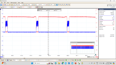

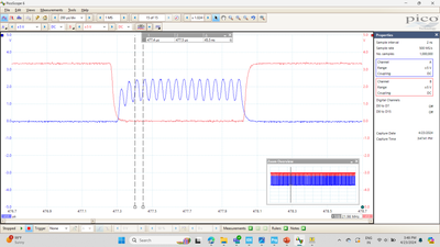

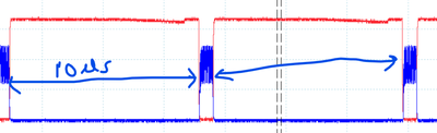

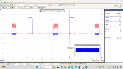

I'm working on optimizing SPI communication on an STM device, and I'm encountering an issue with the timing of SCLK pulses. After transmitting 16 SCLK pulses, there's a delay of 3μs before the next set of 16 pulses can be generated.
I need to reduce this delay to ensure that SCLK can be immediately generated after CS goes low. Can anyone suggest methods or configurations to minimize this delay and maintain a continuous SCLK stream after CS is pulled low?
I'm trying to achieve sampling rate for ADC ADS7046 interfacing.
sclk take same time even not used CS.
I want to sclk immediately on after cs low.
Below I attach some snap of spi cycle.

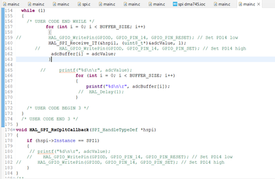

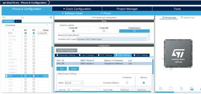

Thanks for reply. I also used DMA with normal mode then frame also same as above with additional delay. So then I am trying with circular DMA that time data not read as given. and SCLK generated continuous and cs not toggle. please can you provide one example code with stm32h745 SPI DMA. I want to achieve 3msps sampling rate for ADC ads7046.

The timing above does not look like hardware NSS. When using hardware NSS the timing between NSS and clock and between transfers is set by SPI_CFG2_MIDI and MSSI. HAL will probably have a way to set hardware NSS and those values, adding however a level of obfuscation between the reference manual and theseetings needed by HAL

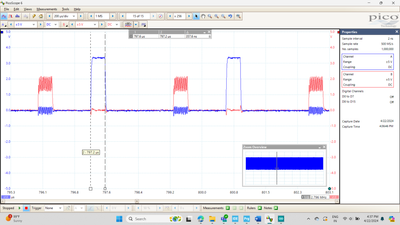

now i used with hardware nss
blue= sclk, red= nss
how can i minimize sclk time
without buffer print it also take same time.
