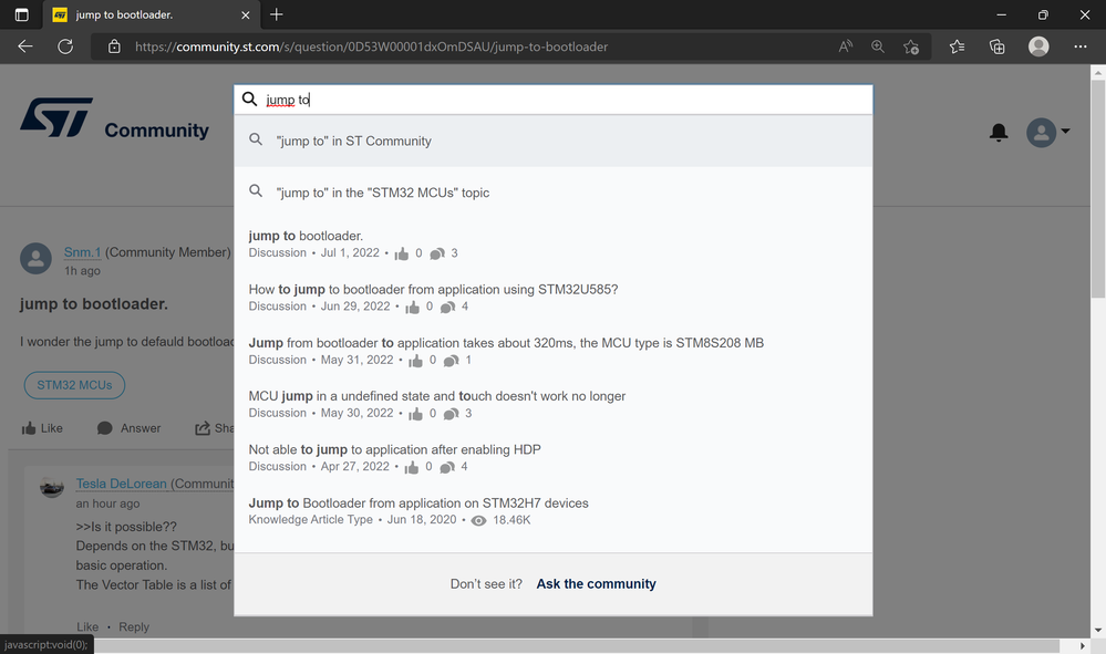

I wonder the jump to defauld bootloader with a software way. is it possible??

>>Is it possible??
Depends on the STM32, but yes generally possible, the MCU has control-transfer methods as part of it's basic operation.
The Vector Table is a list of addresses, you can use function pointers.

Try search first ...
‎2022-07-01 4:10 AM
I didn't found, therefore i ask.
