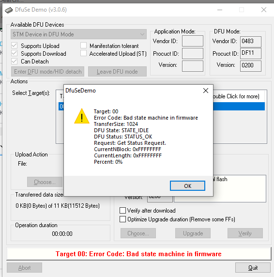

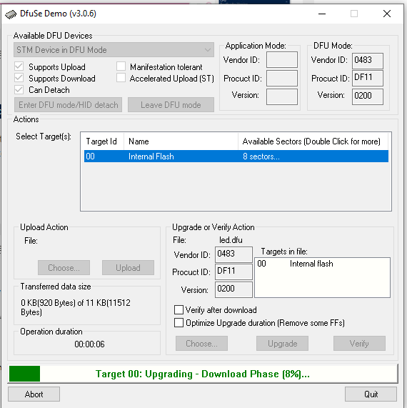

But when I want to upgrade the device again with DfuSe Tool, DFU process stuck or gives me error. Please see below screenshot.
0693W00000NsWVVQA3.png0693W00000NsWVfQAN.pngUpgrade file is simple LED blinking application. It works when I do the DFU first time. But for upcoming DFU does not work.

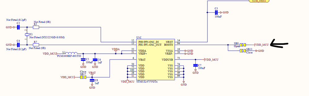

I have tried with BOOT0 Pin tied to 1 by shorting SB9.
By doing that device is able to detect in STM32CubeProgrammer as USB device.
It can flash the firmware but flashed firmware doesn't run properly. i.e. I have flashed led blinking program. LED does not blink. It stays continuously ON.

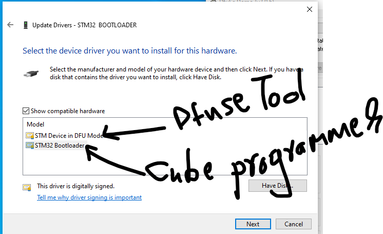

Another observation is, there are 2 drivers for USB.
0693W00000Nsg5mQAB.pngBy installing first, device is detected in DfuSeTool and by second it detects in STM32CubeProgrammer.
When I install first one, It stays detected in boot mode in DfuSe tool even after I press Leave DFU Mode. This change I observed after BOOT0 pin tied to 1.

The right driver to use is STM32 Bootloader.
You'll have to keep the BOOT0 pin to 0 as you're doing your own bootloader.

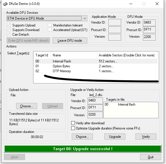

One more interseting thing I noticed when I installed STM Device in DFU Mode driver to use with DfuSe Tool.
I can see 3 target here instead of 1.

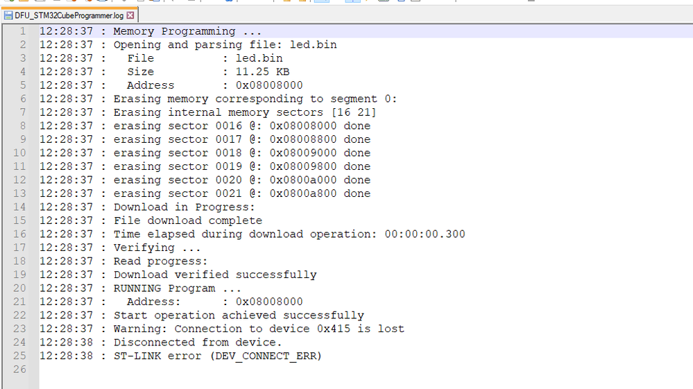

But now again I have wanted to flash the new application. SO I pressed the User Button (Blue button) when releasing the Reset button. So it went into the DFU mode and can be detected with STM32CubeProgrammer. Now with that I have tried to flash the new LED blink application and it failed. Attached are the STM32 Cube Programmer logs.
Mike_ST
June 29, 2022
That's because the flash is no more empty after you flashed the LED app.
I think the DFU protocol implementation is incomplete.
