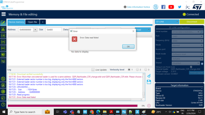

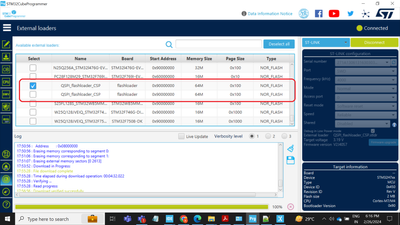

Certainly, I've noticed an interesting phenomenon while programming a device using STMCubeProgrammer for verification purposes.
Here's a step-by-step breakdown of the process:
  1. Begin by downloading two different .stldr files.
2) Duplicate one of the .stldr files and attempt to read data from it. However, when selecting the address as 0x90000000, an error occurs.

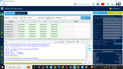

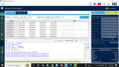

3) Revert to the original file, reconnect the device, and successfully read data from address 0x90000000.
5.Reconnect the device again and initiate programming with the verification option checked, which is successful.
6.Subsequently, without making any changes or selections, attempt to program and verify again, and surprisingly, it verifies successfully without repeating steps 1 and 2.
Note: Initially, it's necessary to perform steps 1 and 2. However, after that, the verification process succeeds without needing to repeat those steps.
