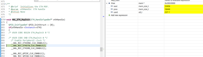

I manage to track down what appear to be written in the memory area dedicated for the LWIP heap. It occurs in the HAL_ETH_MspInit ("void HAL_ETH_MspInit(ETH_HandleTypeDef* ethHandle)") with the line "__HAL_RCC_ETH1MAC_CLK_ENABLE();"  as you can see in the picture
FAV_Before-__HAL_RCC_ETH1MAC_CLK_ENABLE.PNGFAV_Before-__HAL_RCC_ETH1MAC_CLK_ENABLE.PNG
> FAV_After-__HAL_RCC_ETH1MAC_CLK_ENABLE.PNGFAV_After-__HAL_RCC_ETH1MAC_CLK_ENABLE.PNGFAV_After-__HAL_RCC_ETH1MAC_CLK_ENABLE.PNG
Before the call, the ram is zero, after the call the ram is full.  You can also see in the Expressions panel on the right that before the call, lfree is empty, and after the call lfree is not empty anymore and point to some random chunk.

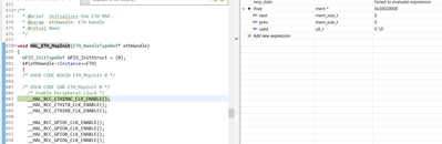

I have the same issue on NUCLEO-H743ZI2 board.
Before calling __HAL_RCC_ETH1MAC_CLK_ENABLE(); macro in HAL_ETH_MspInit() function, all LWIP heap area is zero. After calling this macro, LWIP heap area is corrupted.
Before calling the  __HAL_RCC_ETH1MAC_CLK_ENABLE();
After calling the  __HAL_RCC_ETH1MAC_CLK_ENABLE();
