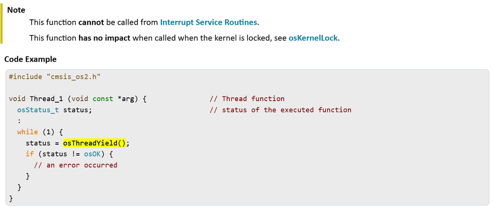

Hello @Saket_Om
I've 5 tasks to poll a lots of devices connected to 5 RS485 busses, so all tasks must have same prio. According to your answer, I think it is best to put all real time stuff into IRQ handler(s) and put all uncritical code into tasks triggered by IRQ handler.
Can you pls explain or pass me a link why osThreadYield() is not needed at IRQ exit but portYIELD() is required?
Hello @regjoe
Please look to the link below:
CMSIS-RTOS2: Thread Management
It is mentioned that the osThreadYield() function cannot be called from ISR.
