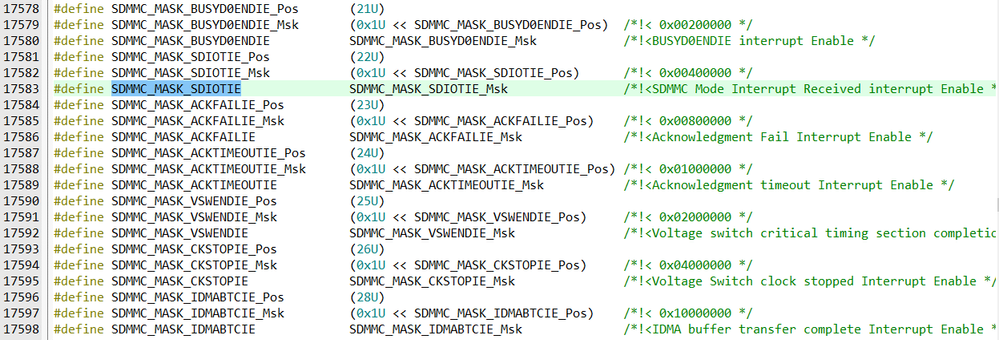

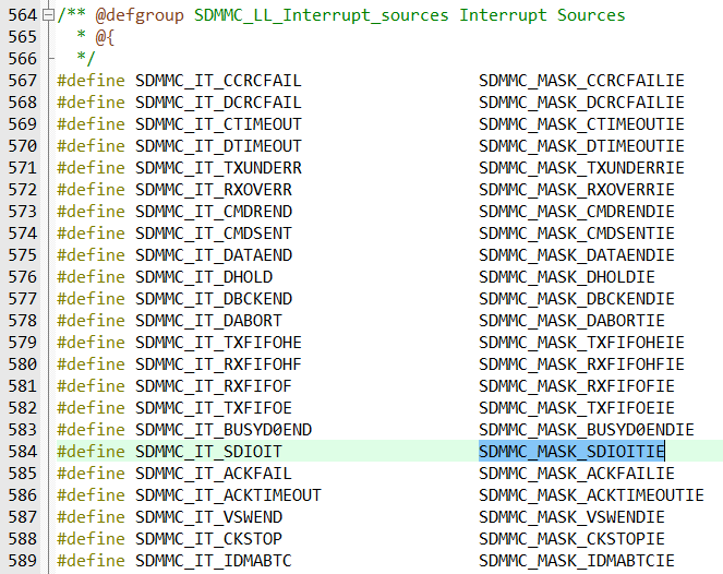

Is this a mistake in the HAL library about the macro definition of the SD card?
one V
stm32h743​xx.h:
stm32h7xx_ll_sdmmc.h:

This issue is already fixed in the STM32CubeH7 v1.4.0 as follow :
in the stm32h7xx_ll_sdmmc.h:
#define SDMMC_IT_SDIOIT                    SDMMC_MASK_SDIOITIE
In the stm32h743xx.h :
#define SDMMC_MASK_SDIOITIE               SDMMC_MASK_SDIOITIE_Msk                /*!<SDMMC Mode Interrupt Received interrupt Enable */
