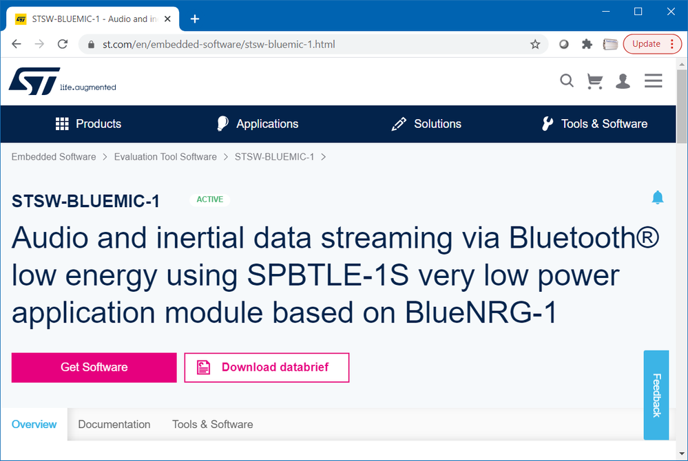

Andrew Neil
Note that Audio over BLE is a pretty recent addition to the Bluetooth specs - are there many (any?) phone which support it yet?
" As far as I know, I need (sic) to use I2S to use audio output"
You don't need to - there are plenty of other ways to transport audio.
"can I know an example or something to refer to?"
putting "st ble audio" into google, the very first hit is:
