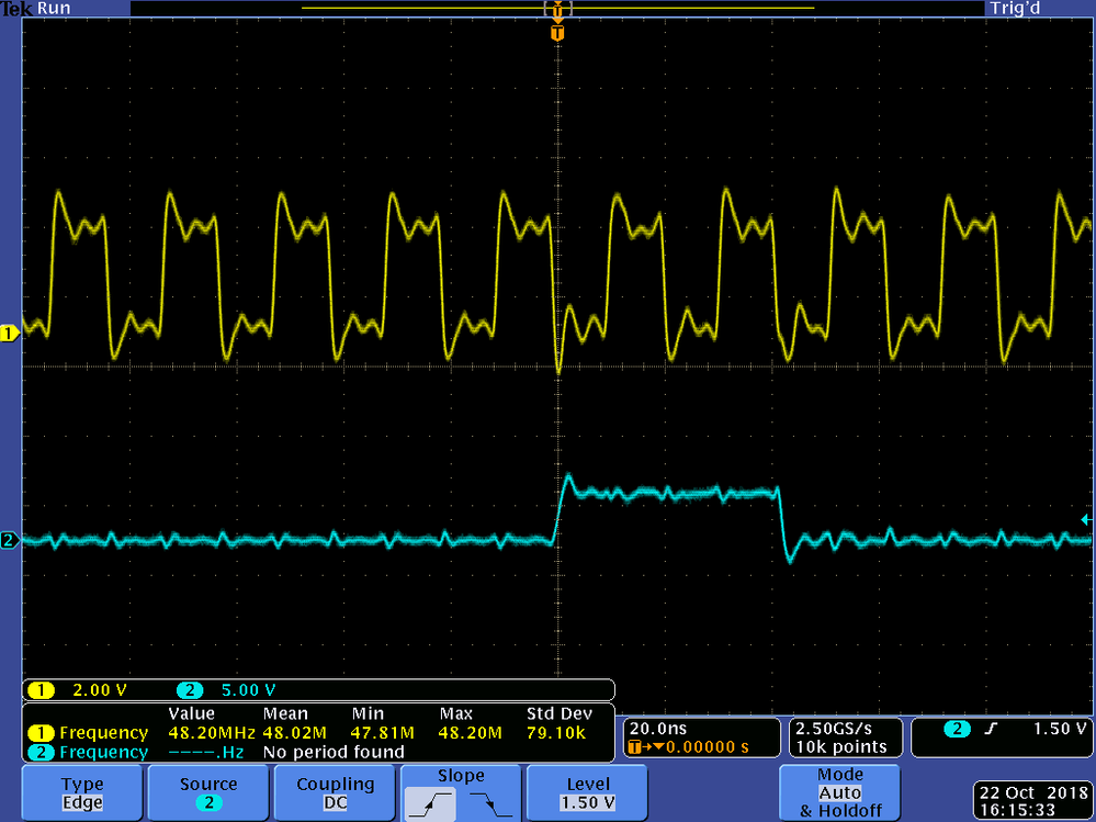

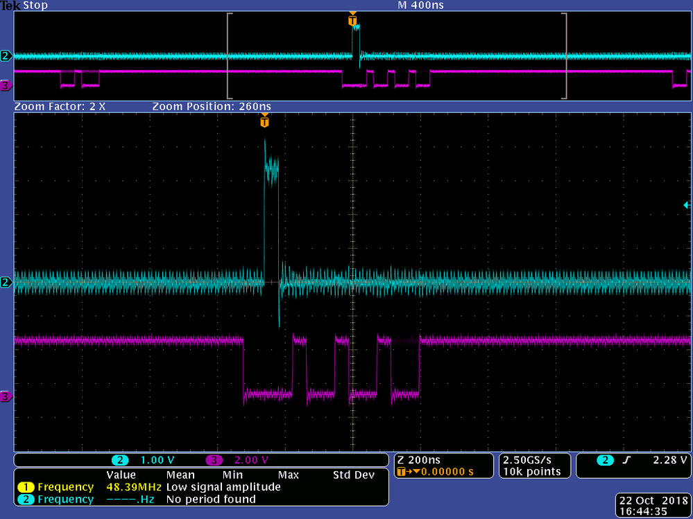

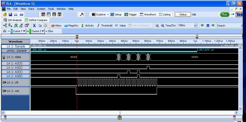

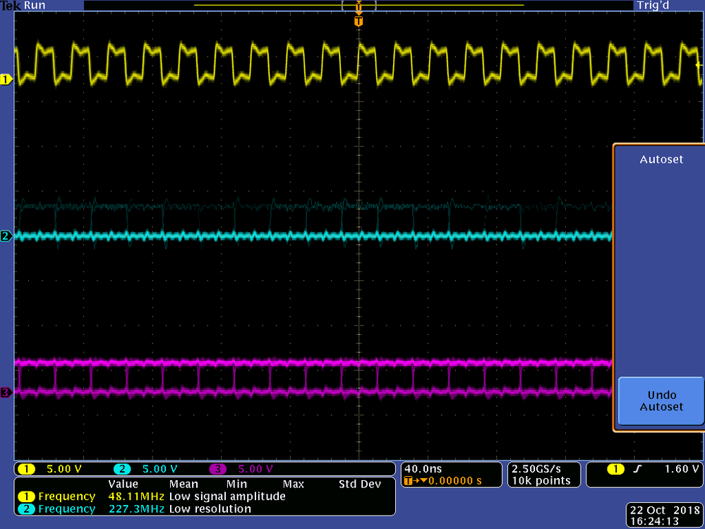

‎2018-10-23 11:32 PM

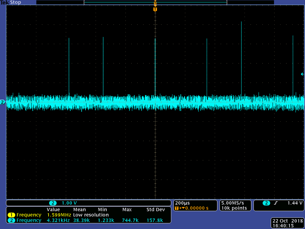

Hey @Community member​ I have reconsidered my options and it turns out it is necessary for me use FIFO. I decided to go for FMC as you suggested. My FIFO is synchronous so i have selected burst read write mode of PSRAM for building my FIFO controller. Since I m having a nucleo144 board with stm32f767zi , I decided to write a small test code for FMC based FIFO controller. My code has an array of type uint8_t and size 500. The content of array is like{0xFF,0x00,0xFF,0x00,0xFF,0x00,0xFF,0x00......... 500 times}. I send this to fifo using fmc and then observed the corresponding pins on oscilloscope. I expected the output to be somewhat like Fig 1 with write enable signal.
But I m not getting out as above. Please look at the following oscilloscope screenshots.
here the yellow wave is clock, My HCLK =96 MHz and FMC_CLK= HCLK/2= 48 MHz which is correct. The channel 2 (blue ) is data(only 1 bit that should go 0,1,0,1,0...and so on). It shows faint appearing and disappearing square pulses. Pink channel is Write enable signal.
My problem is when i trigger the oscilloscope for data signal and capture waves i see something like this.
so my data bit is high for 2 FMC_CLK instead of 1 . Further when i observe Write enable signal along with data signal i see this.
since WE(write enable ) is going low and high but data is not changing so garbage values will be pussed in FIFO.
When i increase scale of oscilloscope and trigger the data signal i see this
The frequency of incoming data is very small.
Can you please have a look and help me out?

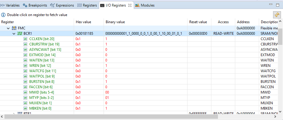

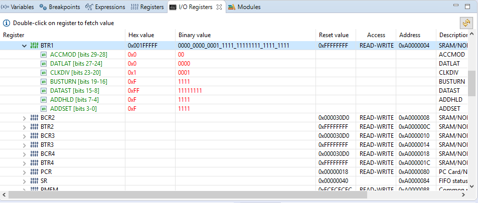

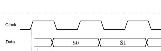

I have reffered to Ch 13 of RM0410 to check out the required configration of FMC_BCR and FMC_BTR registers. I have run my board in debug mode and checked the values of these registers. Have a look
This is the content of BCR register.
This is the content of BTR.
Please let me know what you think about it and how can this issue be resolved.

‎2018-10-24 3:27 AM
do you have A11 as the address strobe ?
the Ffo Address is 0x6000 0800 using A11 ?
I am confused, but thats ok...
you will learn by teaching me about your board.
in this code you have:
/* Write data to memory */
for(; BufferSize != 0; BufferSize--)
*(__IO uint8_t *)psramaddress = *pSrcBuffer;
pSrcBuffer++;
psramaddress++;
it looks like you transfer your entire BufferSize..
can you see this section on the scope, its as tight as C can go. ( DMA would be faster or ASM)
this should be transfering at least 10MHz, that is max 0x1F4 length x 0.1uS = 50uS, is that about right ? on the scope ?
I glazed over your code.
I wouldn't use HAL to transfer data through the Fifo.
the snippet above /*write data to memory is all you need..

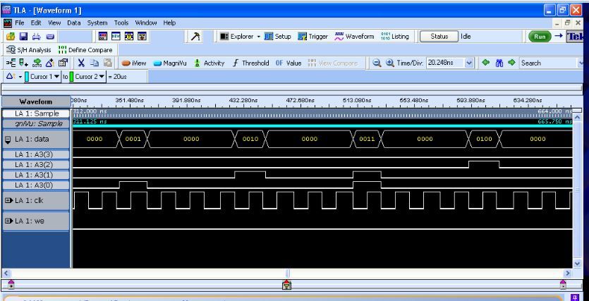

‎2018-10-30 1:44 AM
I modified my code as you suggested . Now I m sending 4 values and then waiting for 1 sec. I observed the output on logic analyser. In figure 1 i can see that data is coming in correct sequence ie 0X01,0X02,0X03,0X04.
But data is not coming out at every clock and also write enable is low . See Fig 2. Data is coming once in 4 clocks.
This will lead to writing of lots of 0X00 along with required data points. How can we get one data per clock ? Or How can write enable be low only when valid data is getting outputted?
‎2018-10-30 1:51 AM
Actually i dont need address since i want to write to a FIFO. But since i m using PSRAM controller of FMC for generating my waveforms hence i m forced to enable address. I m not clear about how all DMA channels are related to each other. Since ethernet is already using DMA. I dont want to mess with DMA here untill n unless absolutely necessary.
‎2018-10-30 3:16 AM
good work, the data looks great on the new scope.. nice and stable.
you seem to be writing a 32bit number @ 8 bits x 4 times. hence the 4 clock strobes.
I am out of my depth when it come to casting peripherals...
please post the current code in a zip file here... I will check if I can help
