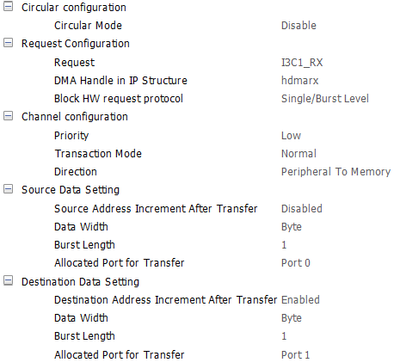

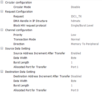

I'm trying to integrate I3C with DMA capability in my project (NUCLEO-H563ZI). Currently, I can run SPI/UART with DMA enabled, but I3C does not want to join the club (it works with IT, though).
After I configure DMA for I3C in the STM32CubeMX interface (GPDMA1):
RX CH2:
TX CH3:

HAL_I3C_Ctrl_Transmit_DMAI face issues with the later function. Particularly, it fails confirming the existence of the hdmacr handle:
/* Check on hdmatx and hdmacr handle */
else if ((hi3c->hdmatx == NULL) || (hi3c->hdmacr == NULL))But I'm not sure what that means. The DMA handle from the DMA configuration tab is the same for both SPI/I3C since they both are in the same GPDMA 1:
My first question would be, can SPI/I3C live with the same GPDMA resource?
My second question, can I assign a different handle to I3C as they share the same names as in the SPI's TX/RX?

Hello @DanLumi,
Unlike SPI, which requires two DMA channels (one for TX and one for RX), the I3C controller in controller mode needs three DMA channels:
This third DMA channel (CR) is mandatory for I3C DMA operation and is why your current setup fails when the HAL driver checks for the presence of the hdmacr handle.
