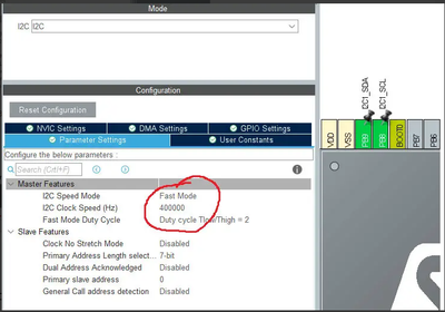

I am using STM32F401CBU6 controller in my project and in this project it consists of 2 I2C slaves 1) Sensor 2) EEPROM.
I2C1 is connected to slave and can able to communicate with the slave, later i have connected external EEPROM, started configuring and while configuring in CUBE IDE it is throwing warning as partly disabled conflict with I2C3 over RCC and SYS.
have checked with clock configurations everything looks fine cant able to figure it out what might causing this issue.
If i ignore and going forward means the sensor which i have connected cant able to receive the device id which is receiving in previous case.
Help me if anyone know about it.
Thank you
ANIL.

Souhaib MAZHOUD
Hello @Anil3
Could you please provide the datasheet of the device (EEPROM) that you use in order to check if the I2C clock speed is correctly chosen in your configuration.
I will be waiting for your feedback.
Thx
Souhaib

Hello again @Anil3
Just let's try to change your configuration to this:
Thx
Souhaib
Hi @Souhaib MAZHOUD
I have made changes as suggested by you but still i am facing the same issue.
