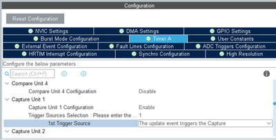

I'm using HRTIM in STM32G474RE to generate a complementary PWMs and trying to capture the frequency of the PWMs by using the capture 1, the trigger sources is "The update event triggers the capture"

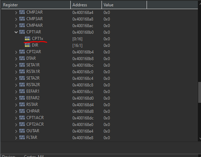

However, when I was debugging the code, the value of CPT1x is always zero
I guessed the capture function does not work, could you please help me to figure out what's going wrong?
Thank you

  • Are you configuring the capture unit through this API HAL_HRTIM_WaveformCaptureConfig() ? This operation is necessary and consists of specifying the source triggering the capture (in your application when the Timer A overflow right ?) On your screen, we also see the HRTIM_CPT1ACR (at the reset value : 0x0) which is the register to program for using the capture unit on Timer A.
