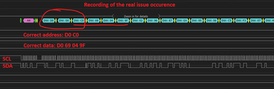

It seems there's a bug in the HAL library causing data bytes to be mixed with memory address bytes when sending data using HAL_I2C_Mem_Write_IT function. The issue was observed on STM32L162VET6 while using I2C as master at 300kHz speed. It is caused by the condition in HAL_I2C_EV_IRQHandler (stm32l1xx_hal_i2c.c) on line 4808.
The issue happens after TXE interrupt occurs (DR is waiting for another byte of data) and your interrupt routine is not fast enough to provide DR with another byte of data, before all bits from SHIFT register are sent out. In that case, a BTF interrupt occurs, causing the code of the HAL_I2C_EV_IRQHandler to go for I2C_MasterTransmit_BTF instead of I2C_MasterTransmit_TXE function. The problem is, that I2C_MasterTransmit_BTF doesn't handle memory address. It only copies another byte of data from data buffer. The issue is invisible when the situation happens while sending out the data buffer. But if it happens during sending out the memory address it causes mixing of data byte with address bytes. That can lead to serious troubles.
Occurrence of the issue is sporadic, as the BTF interrupt must occur while sending the address bytes. But it happens. Moreover, it can be well simulated by inserting a targeted pause into the interrupt routine.

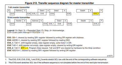

How is it possible for the BTF (Byte Transfer Finished) flag to be set during the addressing step? According to the reference manual, the BTF flag should only be set once the data transfer has been completed.

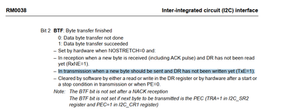

I apologize for not responding sooner. Well, according to the refecrence manual I understand BTF flag a bit differently. See:
So as I posted earlier. The BTF interrupt occurs when the previous byte from the shift register has just been sent out and the data register has not been written yet with another byte (there's no new byte ready to send). If your interrupt routine is a bit lazy - happens especially with higher I2C speed - then you run across the BTF interrupt.
