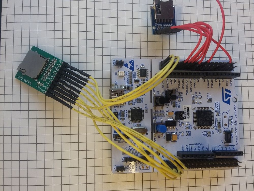

And use the drivers that are linked in that post with the fatfs middleware. I got it successfully working on an stm32l476rg-nucleo with an SD card break out board from adafruit.
0690X000006CGatQAG.jpgYes, the AdaFruit SPI implementation (see BSP) for NUCLEO is also a good starting point but the NUCLEO-L476RG also supports SDMMC and will be significantly faster.
