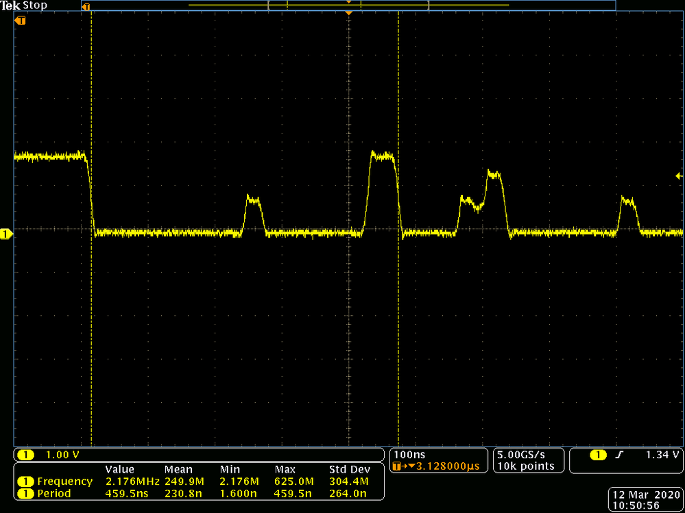

I am testing the ethernet on our custom board with a STM32H745IHx MCU attached to an 8740A phy chip. We want to use RMII mode. Currently, I am failing the loopback test. We are not sure why this failure is occurring.
‎2020-03-11 12:14 PM
I put my code on a nucleo board, and the loopback test works, so I don't think it's my code. This problem occurs only on our setup. I have included a schematic of our setup so you can see it clearly.
The loopback mode is enabled by setting the loopback bit in the BCR register. The chip should send back on RXD0 and RXD1 what the MCU sends out on TXD0 and TXD1. I am wondering if we have an issue with the clock. Any ideas?

This is a screen capture of a scope trace of TXD1. This signal looks strange. We disconnected TXD1 from the phy so we could see only what was coming out of the MCU. Any ideas why this is happening?
‎2020-03-13 11:43 AM
Check the solder quality. Check the GPIO configuration, probably try different speeds for pins.

We cleaned up the signal, and we got loopback to work on a 1.8V nucleo.
The key issue was here:
GPIO_InitStruct.Pin = ETH_TX_EN_Pin|ETH_TXD1_Pin|ETH_TXD0_Pin;
GPIO_InitStruct.Speed = GPIO_SPEED_FREQ_VERY_HIGH; <------------------- This line was to low
GPIO_InitStruct.Alternate = GPIO_AF11_ETH;
HAL_GPIO_Init(GPIOG, &GPIO_InitStruct);
Once we set the gpio speed to very high, loopback started working at 1.8V on the nucleo
