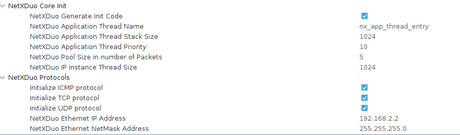

Here is my feedback:
1) I Do Not see a "Common Init" feature, but I do see in the NetXDuo Core Init this:
0693W00000aIcG2QAK.pngAs you can see here, I do not see a check box to disable DHCP.
Perhaps I need an updated version of CubeIDE/MX or perhaps there is significant detail you have not revealed.
2) Have you tried this using my code or is this an untested suggestion?

Done.
CubeIDE: Version: 2.0.100.202301271415
CubeMX: Version: 6.8.0-RC4
Re-Built - No errors
Did not fix the problem.
