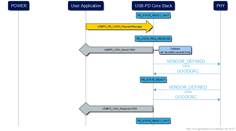

I'm trying to send and receive Unstructured Vendor Defined Messages with the ST USB-PD stack but there is very little information in the documentation about the API.
I have found that I need to call USBPD_PE_UVDM_RequestMessage after which the stack will fire the USBPD_VDM_SendUVDM callback. However, the stack usually calls this function more than once, and it's not clear how to send more than 1 VDO.
Am I supposed to copy all of the data to the address given by pVDO or only copy 1 VDO each time the function is called? What is the maximum number of VDOs that I can send? Why does the stack call this function more than once when I can see on a PD traffic analyzer that only 1 message is sent over the wire?

‎2021-08-30 12:34 AM
Dear @NathanWolcott​
Please find the associated Message Sequence Chart:
Link to collision avoidance in PD3.0, there is a delay in the stack before really sending the UVDM message. It is why the callback is called several times.
Before sending a new message to UVDM, you should wait for notifications of the stack that you are in ready state (notification 'USBPD_NOTIFY_STATE_SRC_READY').
Maximum of VDO for a UVDM message is set to 7 (1 UVDM header + 6 other VDO).
Then maximum size of pVDO is 6. pNbData is this number.
