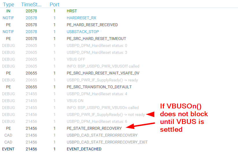

BSP_USBPD_PWR_VBUSOn() & BSP_USBPD_PWR_VBUSSetVoltage_Fixed() in source operation:
- Same as above, should these functions block until the VBUS voltage is settled or should they return immediately?
- What is the maximum allowed blocking duration? Spec for tSrcTurnOn is max 275ms in the PD standard, tSrcReady is max 285ms.
- Note, if it returns immediately, the hard resets do not work, since USBPD_PWRR_IF_SupplyReady() is called only once, and VBUS is not > USBPD_PWR_HIGH_VBUS_THRESHOLD at this time. See the attached screenshot.

Regarding your questions, about BSP_USBPD_PWR_VBUSOn() & BSP_USBPD_PWR_VBUSSetVoltage_Fixed(), it is important is that voltage is as requested, at the end of the voltage configuration step (This would be used either for VBUS management on CAD events by DPM, or through the USBPD stack callback USBPD_DPM_SetupNewPower() that will be executed on some specific procedures as PR Swap, Hard reset, ...).
Regarding timing constraints, timing provided in specs concern the whole procedure, i.e. from a CAD event or a PD message, till the completion of the requested procedure. I have no precise figure about the time spent in Stack execution but basically, from event till callback execution, the time spent will be 1 or 2 ms max till application code (DPM or PWR IF functions) are called. So max time constraint applies basically to execution of user code (you should be able to check timestamps of trace events in UCPD Monitor trace to evaluate spent time).
