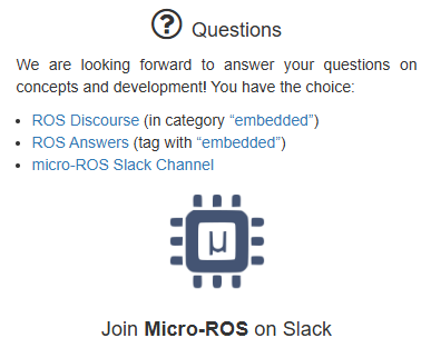

Andrew Neil
More of a question for https://micro.ros.org/ than ST:
