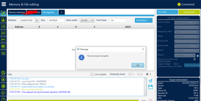

‎2024-03-22 6:37 AM
Just open the CubeProgrammer. Connect to your MCU.
Then open the data file (you can change the suffix to .bin).
Then click on the down arrow on the right of DOWNLOAD button and enter the address on the MCU. For example 0x08001000. It should be on the boundary of the flash erase block.
Then click on DOWNLOAD. Watch your data file programmed on the flash...

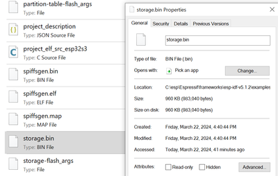

Thanks for the suggestion, followed the below steps
1. I have used the esp32 storage bin file which is been by generated with cacert.pem and confi.ini files.
2. Download it in the stm32 under 0x8001000.
Could you please give me more guidelines on the address and size ?

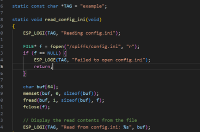

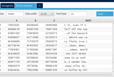

coming to the main question, In the case of esp32 here is the way to check them How can I do this in the stm32
Please find the screenshots :
Hmm... Something like this:
void read_config_ini(void)
const char *config = (const char*)0x08001000;
const char *endptr = memchr(config, 0xFF, MAX_CONFIG_SIZE);
unsigned config_size = endptr - config;
printf("Config:\n%*s\n", config_size, config);
