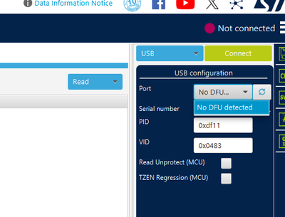

So when trying to connect my STM32 in BOOT0 high mode, I cannot connect it using the stlink-v3set. Instead I would have to use USB for example, right?
Luckily I have a USB-C connected to gnd, D+ and D- to the USB_OTG_FS pins, as seen in the schematics. Therefore I should be able to see the USB in the Port selection of the screenshot? Assuming that BOOT0 is high. And from there I could do a full chip erase to be able to normally program the STM32H755ZIT6 again over SWD with STLINK-V3SET?

If I then pull BOOT0 on high with a jumper wire and connect the USB-C to USB-OTG-FS D+/D- and GND, it should display the STM32 as a Port in STM32CubeProgrammer. Although I haven't uploaded any code yet?

I then tried setting the boot0 to high and doing the reset sequence, and I got the usb connected and did a full chip erase as said.
After that I was able to connect the stm32 in the cubeprogrammer but not in the ide to run my code. In the IDE I got this then i reprogrammed it and it got as prior:

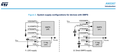

> PWR_DIRECT_SMPS_SUPPLY
You don't have any SMPS circuitry hooked up, so this power configuration is not valid. Switch to the LDO supply in RCC tab, Power Parameters, PWR_LDO_SUPPLY.
The chip is responding and when the program is read, it crashes because the power settings are invalid.
Unclear if you absolutely need VFBSMPS grounded, but if it doesn't work, that'd be the next thing I'd correct.
