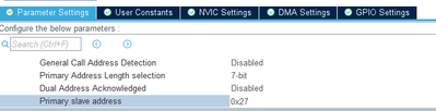

Please check the slave own address; it might be set incorrectly.
Saket_Om
‎2024-08-02 7:51 AM
I set the slave own address

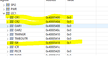

Hello @Bangou_boy
Could you please share with us the content of the CR1, CR2, and ISR registers after I2C initialization?
Saket_Om

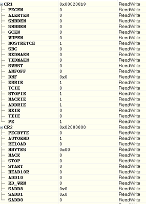

‎2024-08-06 2:43 AM - edited ‎2024-08-06 2:44 AM
‎2024-08-06 2:55 AM - edited ‎2024-08-06 2:58 AM

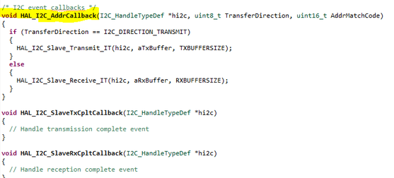

Hello @Bangou_boy
Does the HAL_I2C_AddrCallback() function get called?
The CR1 and CR2 are the control register 1 and 2. You can get their value from the debugger that you are using. STM32Cube IDE for example.
The ISR is the interrupt status register.
You can refer to this thread to know how to get a peripheral register value.
Saket_Om
‎2024-08-06 4:19 AM
Hi @Saket_Om
THank you . please find attached an screenshot of the CR1 CR2 ISR
Yes the HAL_I2C_AddrCallback() function get called.
‎2024-08-06 5:54 AM - edited ‎2024-08-06 6:18 AM
Hello @Bangou_boy
Is the value of the register taken before the callback gets executed or after?
I ran your code on my side and obtained the value of the CR1 and CR2 registers after enabling listen IT. Please see the screenshot below.
Saket_Om

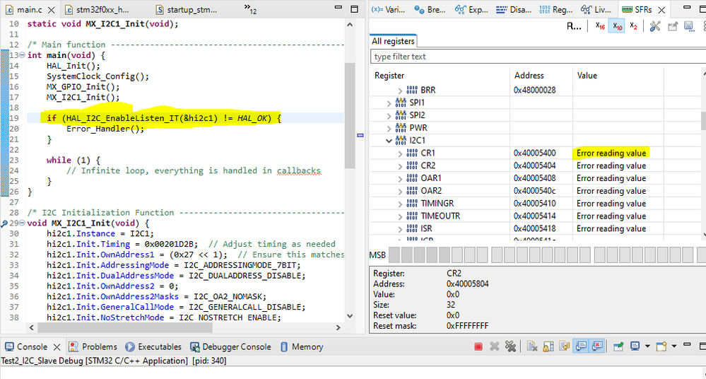

‎2024-08-06 10:12 AM - edited ‎2024-08-06 10:49 AM
@Saket_Om when i debbug it stop at this point , it seems it didn't run the the Enablelisten_IT other it run it but didn't whrite anything in the CR regsister look like yours. Anyway the debbug stop at Enablelisten_IT
