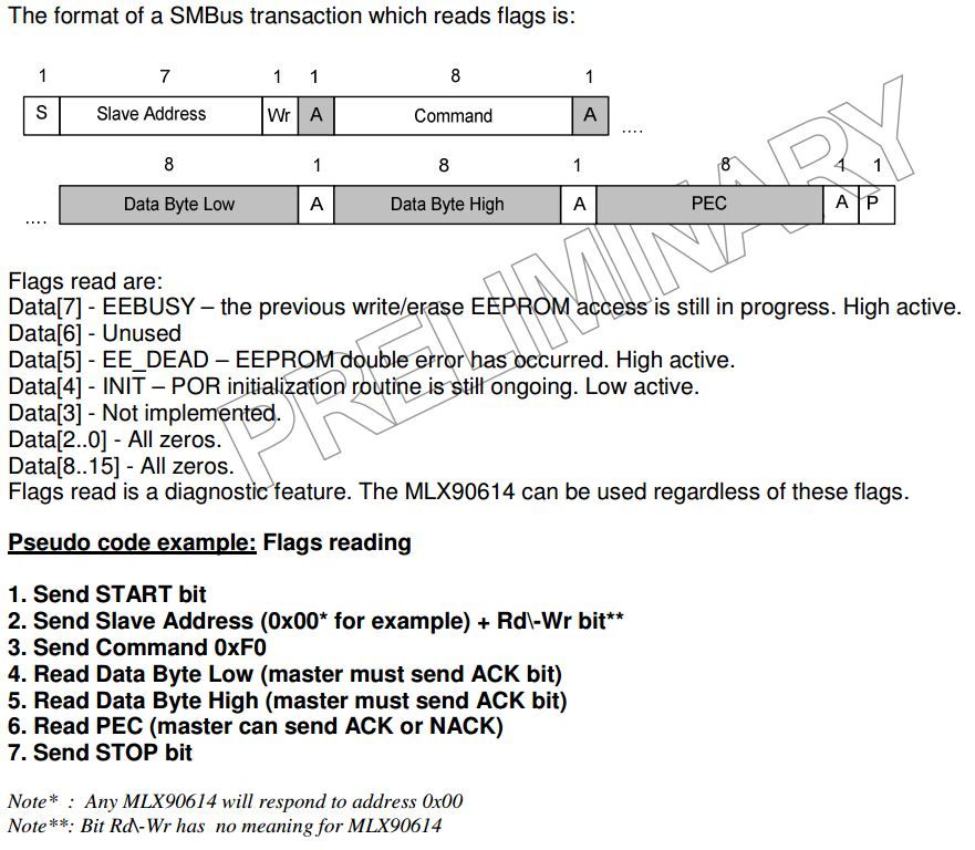

I am trying to read flag on the device MLX90614. datasaheet Page 23. The format of a SMBus transaction which reads flags is: 0690X000008isnLQAQ.jpg
i.e i must send start->slave address->command and right away without send repeat start receive data. how to do it?
i writing code:

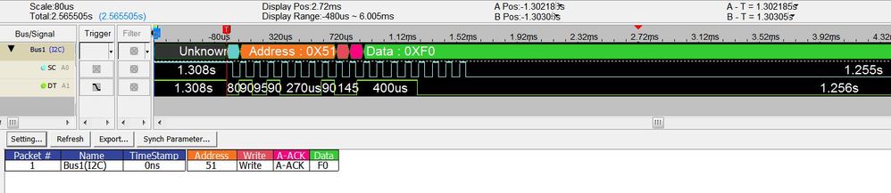

and can transmit command, but can not receive data.
what i receive:
i2c and device working, becausei can receive and transmit data from the device(EEPROM/RAM).
