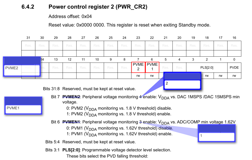

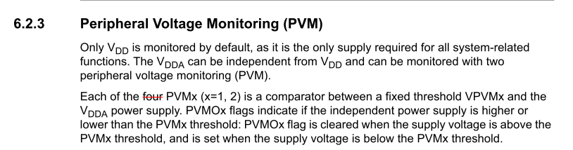

In RM0440 R6 6.2.3 there is "Each of the four PVMx (x=1, 2)". So 4 or 2 PVM ?
In the PWR_CR2 register 6.4.2:
Bit 7 PVMEN2: Peripheral voltage monitoring 4 enable
Bit 6 PVMEN1: Peripheral voltage monitoring 3 enable
=> PVMEN1 is for PVM1 or PVM3?
=> Only 2 PWM specified

So my question: how many PVMs and what bits to use in PWR_CR2 ?

Hello @Nikita91​ ,
Thank you for pointing out this issue.
In STM32G4xx, there is only 2 PVMx (x=1,2).
So, in RM0440 the PVMENx should be renamed to PVMEx (to be in line with HAL definitions):
Also, the mistake of 4 PVM thresholds will be corrected and this text should be updated (remove "..the four") :
Note that the next revision of the RM0440 is planned in the first quarter of 2022.
Thank you once more for your contribution.

Thank you for the manual clarification.
But what is the correct PWR_CR2 bit to use for PVM1: bit 6 as in RM or bit 4 as in stm32G431xx.h ?
It's Bit 6. as in RM0440.
