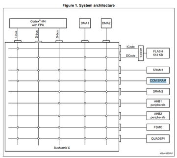

In the linker script provided by STM for STM32G474RETx, the memory section is:
MEMORY
   CCMSRAM    (xrw)    : ORIGIN = 0x10000000,   LENGTH = 32K
   RAM    (xrw)    : ORIGIN = 0x20000000,   LENGTH = 128K
   FLASH    (rx)    : ORIGIN = 0x8000000,   LENGTH = 512K
 But in the reference manual RM0440 section 2.4 page 88  it states that:
Category 3 devices feature up to 128 Kbytes SRAM:
• 80 Kbytes SRAM1 (mapped at address 0x2000 0000)
• 16 Kbytes SRAM2 (mapped at address 0x2001 4000)
• 32 Kbytes CCM SRAM (mapped at address 0x1000 0000 and end of SRAM2)
I'm confused as to why the RAM is declared as 128K when that's the combined total of SRAM1 + SRAM2 + CCMSRAM, and there's also CCNSRAM declared separately. Is it so that RAM covers all SRAM but you can also place specific things in the CCMSRAM section?

Radosław
Senior III
RAM region should have size 96K.
CCRAM have some limitarion  and with RAM to not create continuos  memory,
Atribbute section will place you variable function in specyfic location.
KnarfB
RM0440 Figure 2. Memory map shows three SRAM spaces acting as one continous data memory: SRAM1 + SRAM2 + CCM SRAM = 128 kB.

Thanks for the explaination. To further clarify, from RM0440 figure 1, it looks like CCM SRAM is connected to both instruction and data buses, as well as DMA peripherals:
 So this would mean I can place not only code but also initialize data in this area correct? And for the usage, I see under RM0440 2.4:
CCM SRAM is mapped at address 0x1000 0000.
Execution can be performed from CCM SRAM with maximum performance without any
remap thanks to access through ICode bus.
The CCM SRAM is aliased at address following the end of SRAM2 (0x2000 5800 for
category 2 devices, 0x2001 8000 for category 3 devices, 0x2001 8000 for category 4
devices), offering a continuous address space with the SRAM1 and SRAM2. CCM can be
accessed by DMA only by this aliased address.
Does this mean for non DMA usage I should be referencing to CCM SRAM in the linker script with the 0x10000000 address?
