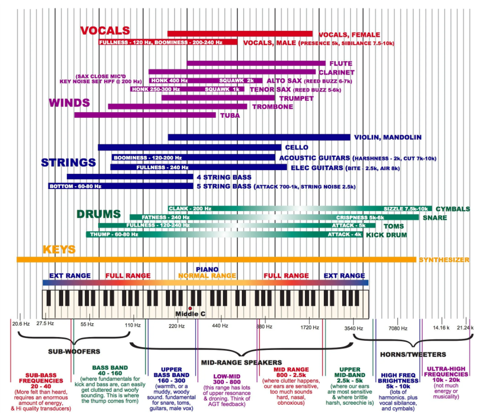

@DElec.1​ "natural sounds" is very vague.
Very few (if any?) natural sounds cover such a wide band.
see, eg,
0693W00000NqYWqQAN.pnghttps://www.reddit.com/r/AverageJoeAudiophile/comments/2rgjl6/the_frequency_spectrum_instrument_ranges_and_eq/
Then again, some natural sounds are beyond that range; eg, bats.

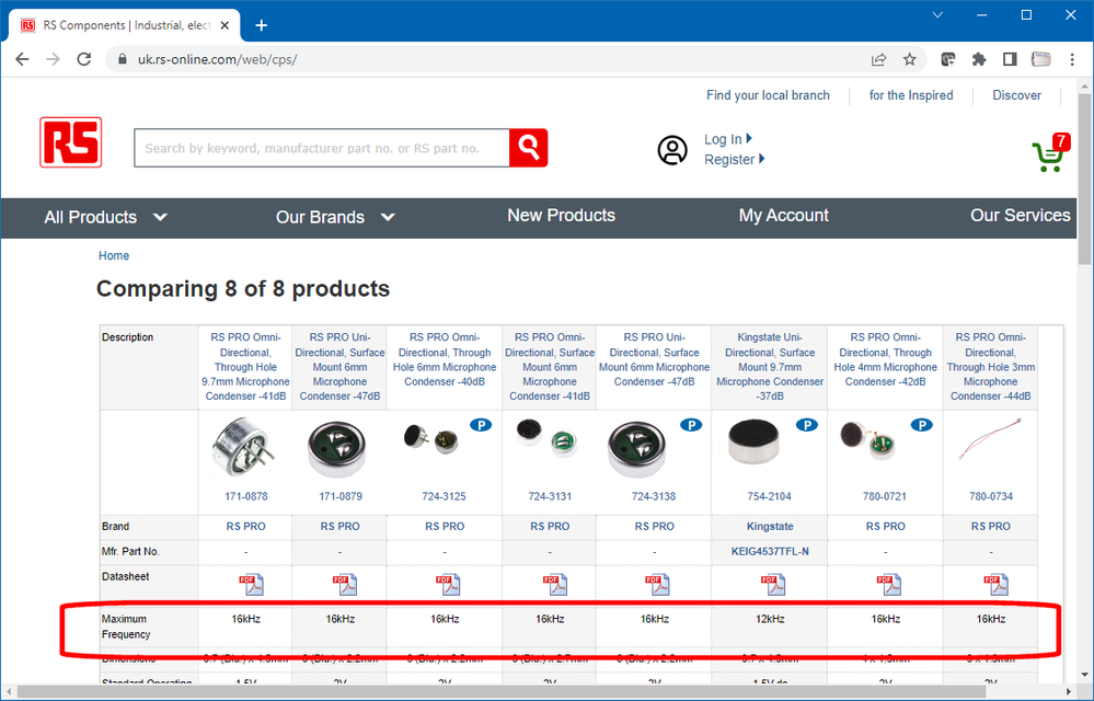

@DElec.1​  "from 20 Hz to 25KHz"
What electret microphone(s) are you using?
Do they actually meet that frequency specification?
some of those only go down to 100Hz; none go below 50Hz.
