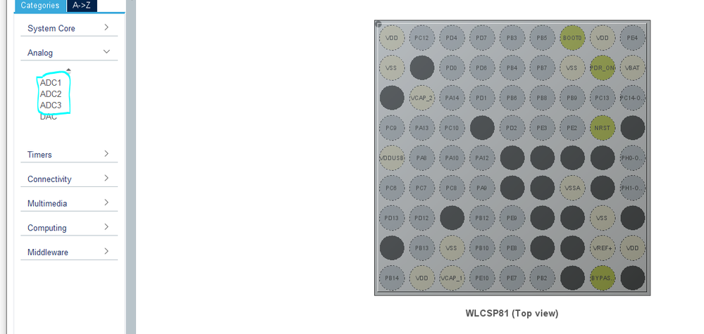

STM32F446 has Maaaaaaany ADC channels distributed into 3 different ADC periprherals.0693W00000NqTlbQAF.png
Available for consulting/freelancing , hit me up in https://github.com/javiBajoCero
and can they be synchronised? So that the 2 "stereo" samples actually happen at the same time.

"at the same time" doesnt exist, is it 40 nanoseconds "at the same time"?
For audio applications i would say yes.
Yes, different ADCs can be syncronized. (not the channels, those are going to be converted in a waterfall fashion)
