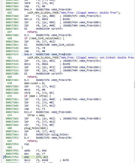

Hello, I'm having trouble about use of lwip on Stm32h743. I'm using udp raw. I'm transmitting packet with 1ms period, there is no problem in sending/receiving. After 20-30 min, program is going to hardfault with 'Imprecise data access violation'. It is occuring at mem_free(void *rmem) function in mem.c file. The stack was just like this: GATEWAY_ADDRESS() -> mem_free() -> HardFault. I'm also attaching the disassembly. Thank you for your helps.
Memory used in malloc/free functions is taken from the heap, not the stack.
Not sure where the implementations of those functions come from in your case, but I would focus on that. And linker script / heap size.

I can not track, because where is the GATEWAY_ADDRESS(), I could not find it. Additionally, I increased the stack/heap size. Hardfault does not occur now, but the connection is getting lost after a while. I can not get answer even when I send ping request. I use the board as server. I checked my raw api functions, I think there is no problem, because they are very simple and looks very similar to examples. Problem is elsewhere but I don't know where :(

I was transmitting the packet in timer interrupt elapsed callback which is equal to 1ms period. I moved the code into my main loop with checking systick so that time period stay same. Now, it is working without any error since the yesterday.
