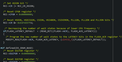

The easy way is to deconfigure the system clock completely. You may call SystemInit(), defined in the system_xxx.c file.
For me, the safest option is to write the bootloader in such a way that it enters the user app right after reset, with the MCU at default settings. This is achieved by putting some magic value in one of backup registers, then resetting the MCU via software. In the first lines of bootloader code, the bootloader checks for his value and invokes the app, skipping the booloader-related MCU configuration code.
My STM32 stuff on github - compact USB device stack and more: https://github.com/gbm-ii/gbmUSBdevice

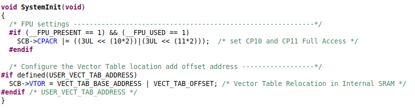

Hi @gbm correct me if I am wrong. SystemInit() is used to set the vector table and has nothing to do with clock configuration and SystemInit() is called in the startup file.
A quick look at SystemInit will show you it does change clock settings.
You are wrong. :)
newbie_stm32
Hi @gbm@TDK thanks for your inputs. I am referring to this. Which is defined in the system_stm32g4xx.c file by STM32CubeIDE.
@TDK can you please point out which file are you referring to?
