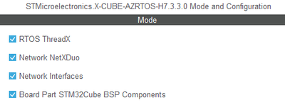

I'm trying to establish a TCP connection between my Nucleo-H753ZI and my PC.
I'm using ThreadX and NetxDuo.
First of all, i'm triggering a hard fault when activating Network Interfaces and then using the debug mode.
I don't seem to have hard fault if i flash the program directly into the board (I have a thread that blinks an LED that still works)
This is my cubeMX configuration :
I installed the following, using the Software Packs Component Selector:
STMicroelectronics-X-CUBE-AZRTOS-H7:
  ThreadX => Core
  NetXDuo => NX Core
  Network Interfaces => Ethernet Interface, Ethernet Phy Interface : LAN8742_Phy_Interface
  Board Part STM32Cube_BSP_Components : ETHPhy / LAN8742
I tried to ping the board using CMD in windows, but i'm guessting that wouldn't work because i haven't added any code in nx_app_thread_entry.

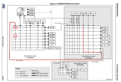

Hi @DmitryR
Actually, the Ethernet MAC has access to AXI SRAM as shown below in the bus matrix.
the only unaccessible memory is the DTCM.
regards
haithem.
@Haitem,
First of all you show the picture for the H723 but @unkn0wn  uses H753. For H753, this link from Ethernet MAC to AXI bridge was added in documentation revision 10 only. I do not know the reason but I know that for silicon revisions Y and V this does not work, I have had this problem myself. Putting Ethernet buffers to AHB SRAM makes it work without any problems.
Regards,
Dmitry

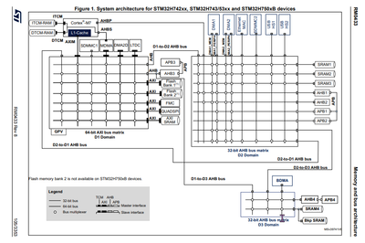

Sorry @DmitryR
Indeed I used the wrong reference manual, here is the correct one to keep the tracking.
