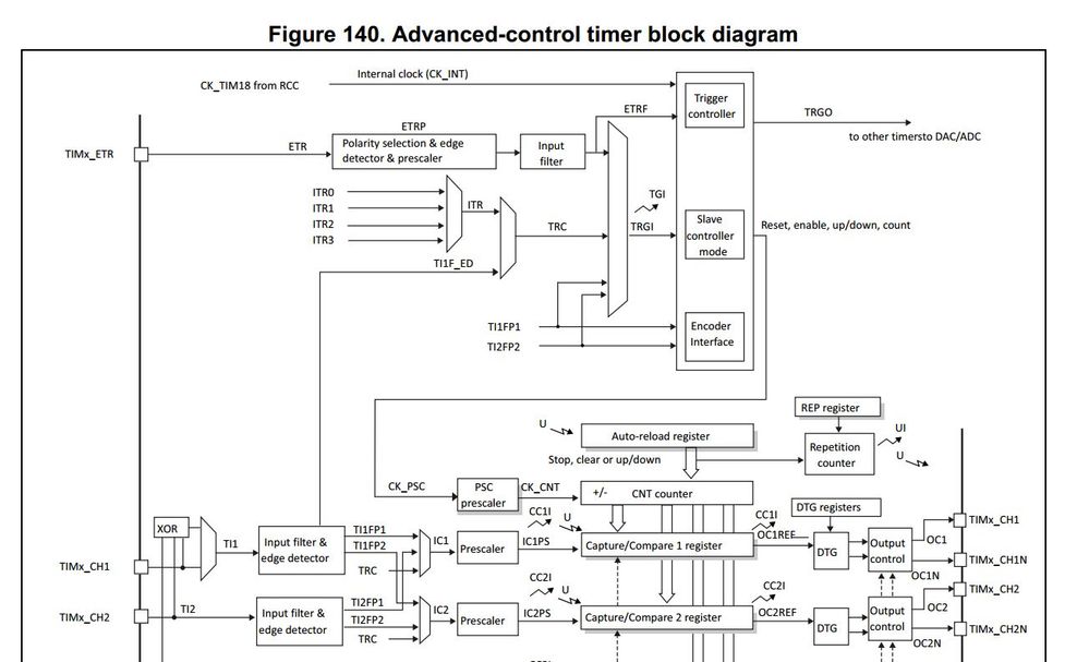

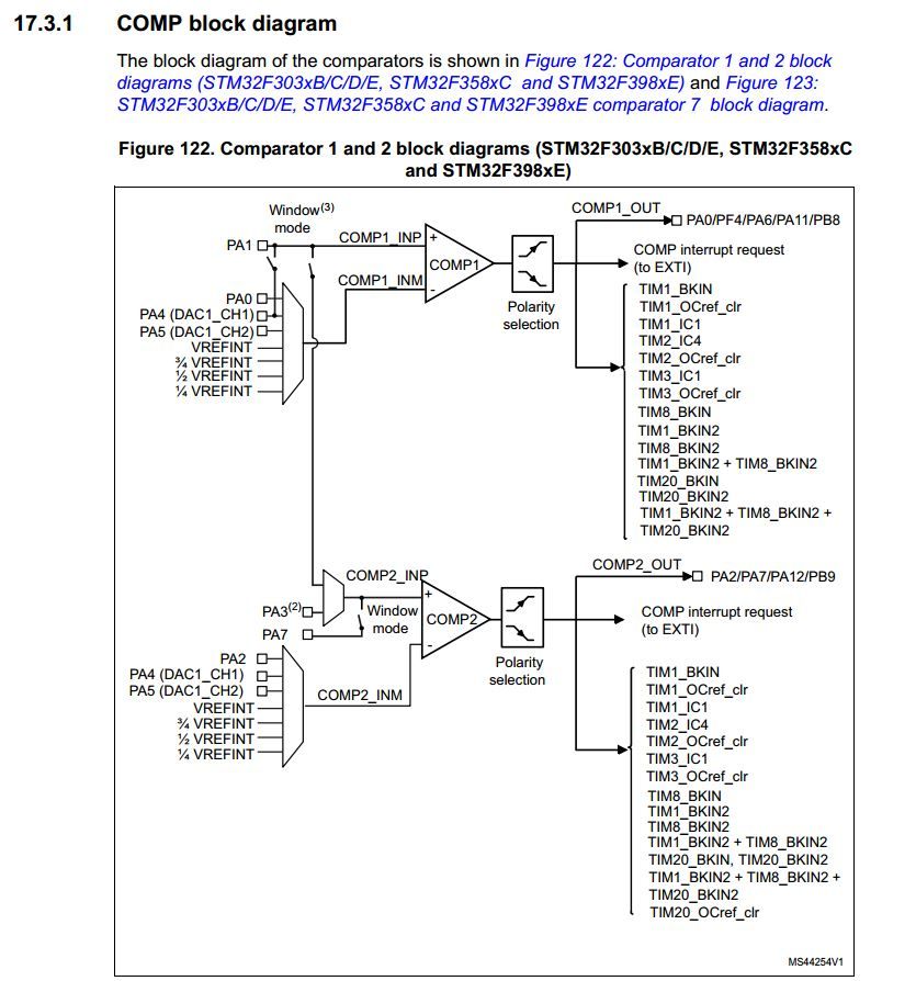

Is there such internal interconnection (comparator-to-capture channel) at all? All I can find in RM is comparator-to-BREAK...
Posted on September 27, 2017 at 13:31
Hi Jan
I believe so, attached the COMP and TIMER block diagrams from the Reference Manual;

the problem seems to be in this line:
sConfigIC.ICSelection = TIM_ICSELECTION_TRC;�?�?
This configuration connects the input capture to the timer trigger.
The correct configuration should be:
sConfigIC.ICSelection = TIM_ICSELECTION_DIRECTTI;�?�?
Best regards,
Adam
Posted on September 29, 2017 at 11:27
Okay, so the internal trigger is somehow routed through the 'normal' inputs, as if it would be part of the GPIO matrix, correct?
Can this piece of wisdom be please conveyed somehow into the *primary* source, i.e. RMs, particularly into the Timer chapter (which currently has only one mention of compare input namely into BREAK2) and possibly also the 'interconnections' chapter too?
