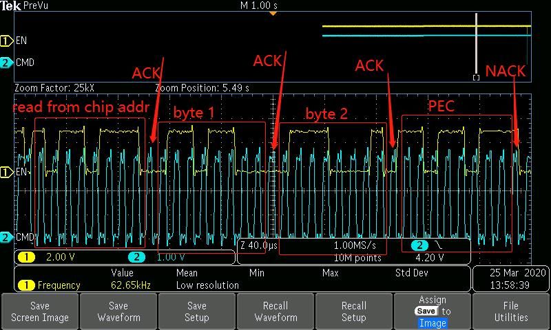

‎2020-03-25 2:56 AM
1.When I was debugging mlx90615, I used smbus to communicate. The reading function was as follows:
uint32_t I2C_Read_Cmd_Data (SMBUS_HandleTypeDef *hsmbus1, uint16_t chip, uint8_t *cmdBuffer, int32_t cmdBufferLen, uint8_t *dataBuffer, int32_t dataBufferLen)
uint32_t ret_code = I2C_OK;
if(HAL_SMBUS_Master_Transmit_IT(hsmbus1, (uint16_t)chip, (uint8_t*)cmdBuffer, 1, SMBUS_FIRST_FRAME)!= HAL_OK)
while(1);
while(HAL_SMBUS_GetState(hsmbus1) != HAL_SMBUS_STATE_READY);
if(HAL_SMBUS_Master_Receive_IT(hsmbus1, (uint16_t)chip, (uint8_t*)dataBuffer, 3,SMBUS_FIRST_AND_LAST_FRAME_WITH_PEC) != HAL_OK)
while(1);
return ret_code;
but the measurement waveform found that there was always no ack in the last byte (pec), as shown below
Would like to ask where the problem is, please answer, thank you very much

‎2020-03-25 5:15 AM
First off - according to the SMBus spec, the PEC byte is ALWAYS NACKed to signal the end of the transmission (or the last data byte if not using PEC).
Second - go find AN4502 and look at the STACK_SMBUS_HostCommand() function. That function encapsulates all the code for the entire transfer. You can use that function instead of stitching together lower-level SMBus function calls yourself, or just see which flags it sets.

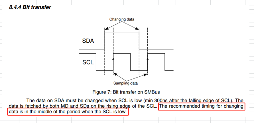

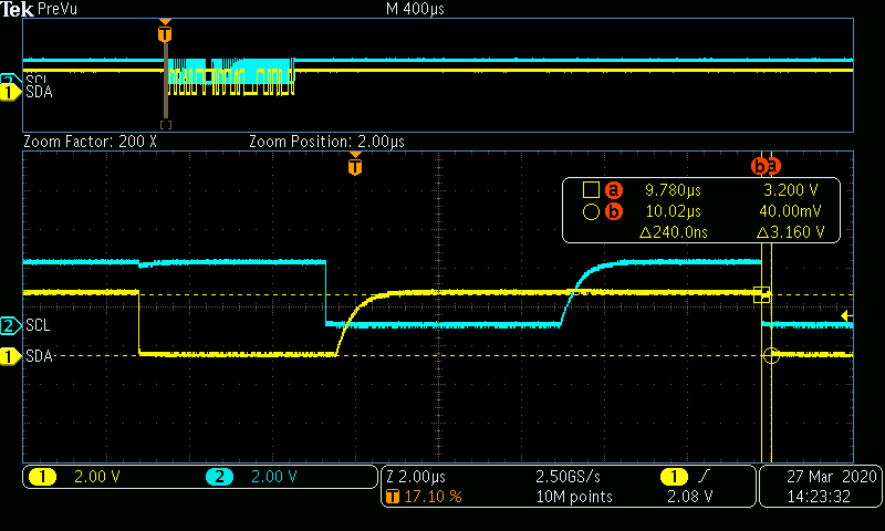

‎2020-03-26 11:37 PM
Bob:
Thank you very much�?
I have rewritten my code with reference to AN4502, I have a question, refer to the chip manual, after SCL produces a drop edge, there must be at least 300ns, SDA can be changed, but my measurement result is only 240ns, how should I set it here?
‎2020-03-27 5:24 AM
What clock freq to you have feeding the I2C peripheral, and what have you programmed into the I2C_TIMINGR register? If you came up with these values on your own you might try using CubeMX to generate a dummy project and see what values it programs into I2C_TIMINGR (make sure to configure the clock tree in CubeMX to match your code).
