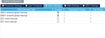

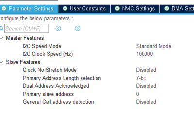

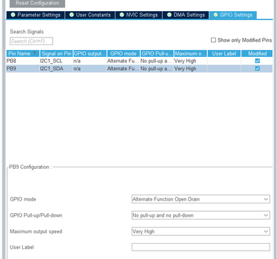

For I2C1 I've used STM32 pins D15(SCL) and D16(SDA) on Right Connector - CN7, but next time also tried A4(SDA) and A5(SCL) on Left Connector - CN9 and set like this in CubeMX:
Did I make a mistake somewhere? Do I need to use other pins? Is this all correct?
Thank you!

Hi @bvujic ,
Set GPIO Pull-Up/Pull-down at : pull-up and set the frequency at 400KHz : " The internal registers and memory of the MPU-9250 can be accessed using either I2C at 400 kHz " MPU datasheet

Pin settings look fine. Seems like a hardware issue. How is the MPU9250 board connected? What board is it? Does it have power? Is I2C mode selected? Are SCL/SDA high when power is connected before any code runs? If not, that's a hardware issue.
