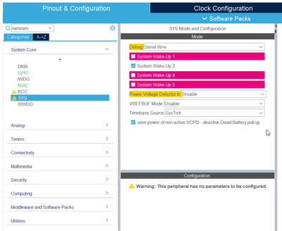

I have a battery powered project, where I want to turn it on with a falling edge.
MCU: STM32G431RB
To save power my plan is to set the STM32 to shutdown mode.
Now my Question is, how can I wake up the MCU from a falling edge?

So how do I configure the WKUP pin to wake up the MCU when detecting a falling edge?
I have only found the option to activate WKUP pin, not how to configure it
Thanks in advance for the help!

To configure the WKUP pin to wake up the MCU from shutdown mode upon detecting a falling edge, you need to use the STM32's EXTI (External Interrupt) functionality.
Ok, thanks for the quick reply!
I still got a few questions...
1. What is the System Wake-up then, if not for waking up? I'm asking because in the documentation it literally says "WKUP pin, configurable rising or falling edge"
2. How does the MCU detect an EXTI if on shutdown mode?! The CPU and all of it's clocks are NOT running in this state, the 1.2V Regulator is turned off...
