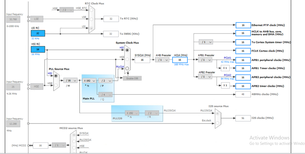

Dear clive1
can you tell me in details what should I do?
should I set the HSE to Crystal/Ceramic Resonator?
what should I do in the CubeMX clock settings? like in the below image?0690X00000Buu7xQAB.png
oeliks
Senior
First enable HSE, in cubemx system RCC->HSE crystal resonator. Then go to clocks menu (image above). Change input frequency from 25 to 8, and check​ HSE option. Change HCLK to desired core clock and allow cubemx to recalculate all prescalers.
Dear Oeliks
I did as you said and I set the HCLK to 16, still it doesn't work
it looks like with each delay, it lasts 1ms more!
for example when I set HAL_Delay(2), for the pin PD12 to remain SET, it remains SET for 3ms!!!
WHY GUYS????
