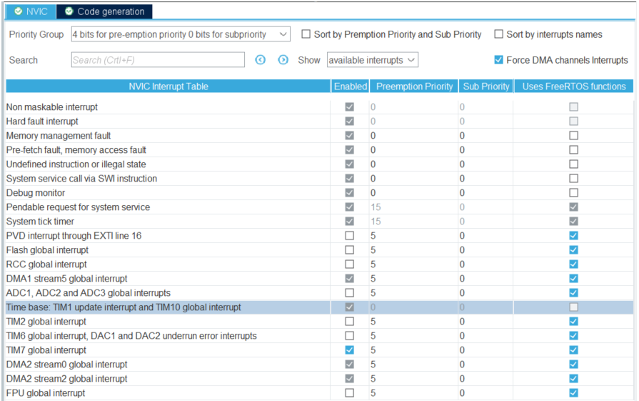

My program keeps crashing in my uiTask loop, and I figured out the common denominator is a call to portYIELD_WITHIN_API().
Here's the relevant code in main. Obviously there are a lot of calls to classes / structs here that aren't shown, but I've sifted through them enough that I don't think they are the issue.

I originally had
flag = osEventFlagsWait(potBufferReadyFlag, POT_FLAG, osFlagsWaitAny, 0U);
set to 10U instead of 0U, and that triggered a hardfault inside xEventGroupWaitBits():
	if( xTicksToWait != ( TickType_t ) 0 )
		if( xAlreadyYielded == pdFALSE )
			portYIELD_WITHIN_API();
Then the next hardfault happens at osDelay(1) in the loop, in the call to vTaskDelay():
		/* Force a reschedule if xTaskResumeAll has not already done so, we may
		have put ourselves to sleep. */
osDelay() gets called in the constructor for my LCD class (before the task loop starts) and does not crash.
Someone posted a similar issue here: https://www.freertos.org/FreeRTOS_Support_Forum_Archive/August_2016/freertos_Usage_Fault_hard_fault_within_portYIELD_WITHIN_API_0efed9eej.html
and it seemed like the problem was interrupt configurations, but I checked FreeRTOSConfig.h and everything looks right to me. I also have a pic of my NVIC priorities in CubeMX:
0693W00000Houx7QAB.png#FreeRTOS​ #HardFault​

NNagy.1
Senior
So I just un-commented all the calls to objects in the task, and now the program is no longer crashing. So maybe it is in fact a class issue. I guess I'll keep trying things.
