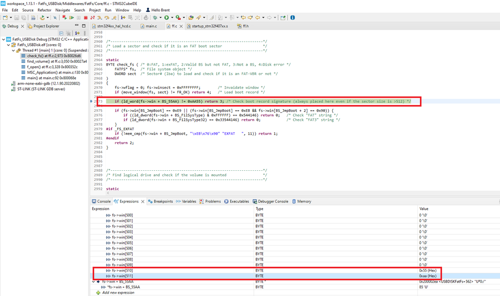

I am trying to dig into this a little more. When starting up the FatFs_USBDisk demo application and running it the first time I plug in the USB flash drive it works. Specifically in check_fs() where it loads a sector and checks to see if it is a FAT boot sector - the boot record signature returned from the check is 0xAA55 (see figure below):

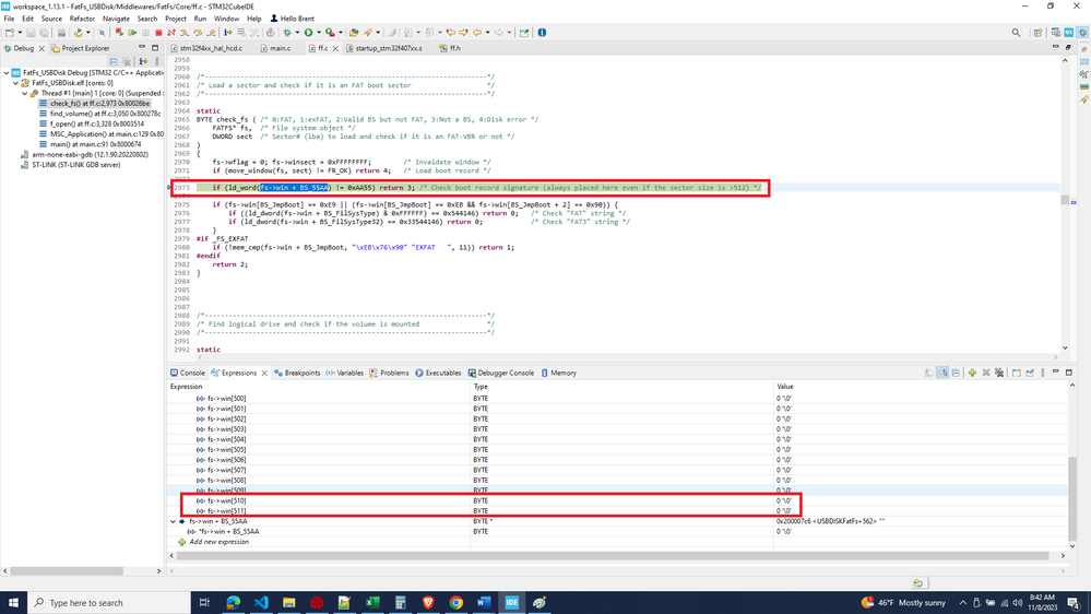

In the case where I unplug the USB flash drive, I see unmount is called, both LEDs turn off as expected. When I plug the USB flash drive back in check_fs() is called but the boot record signature returned from the check is not 0xAA55. It is 0 (see figure below):
Could there be a bug in the FatFs code?
Or maybe I am not running the demo application as expected?
Any thoughts on what I might be able to try?

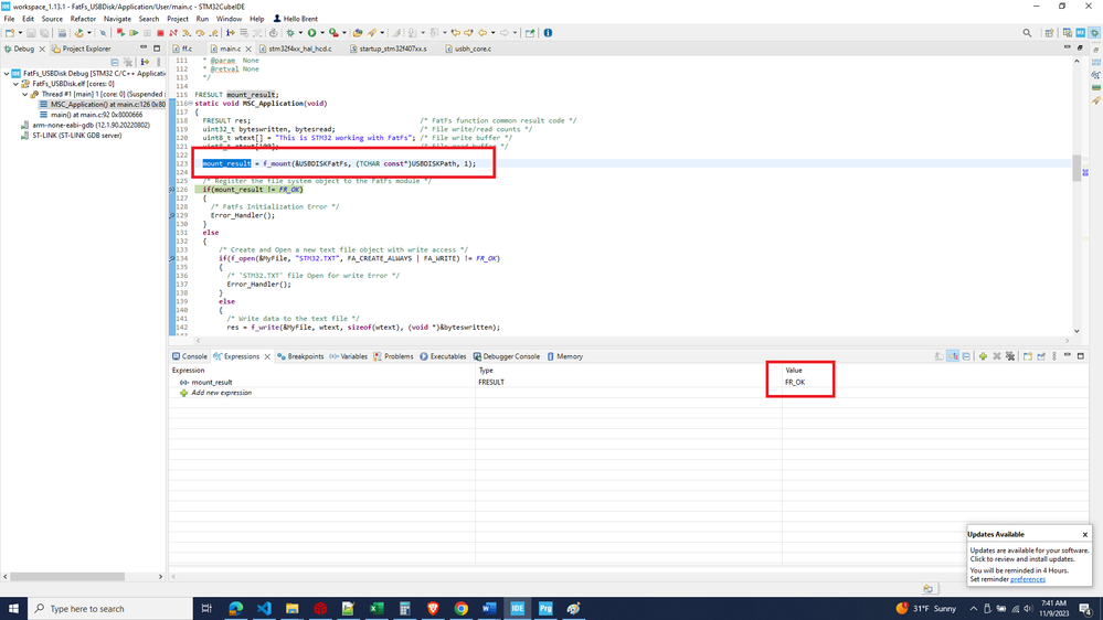

I changed the the last parameter of the f_mount to 1 to mount immediately.
mount_result = f_mount(&USBDISKFatFs, (TCHAR const*)USBDISKPath, 1);
/* Register the file system object to the FatFs module */
if(mount_result != FR_OK)
	/* FatFs Initialization Error */
	Error_Handler();
When I first run the demo application and plug in a USB flash drive the f_mount() returns FR_OK. The application continues to run properly and writes/read a file to the USB flash drive. The green LED turns on.

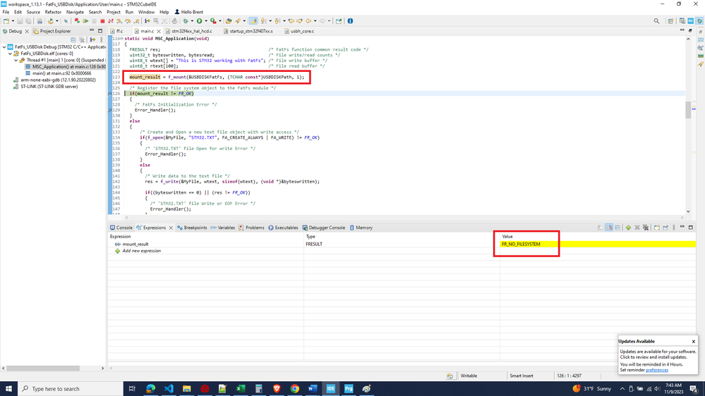

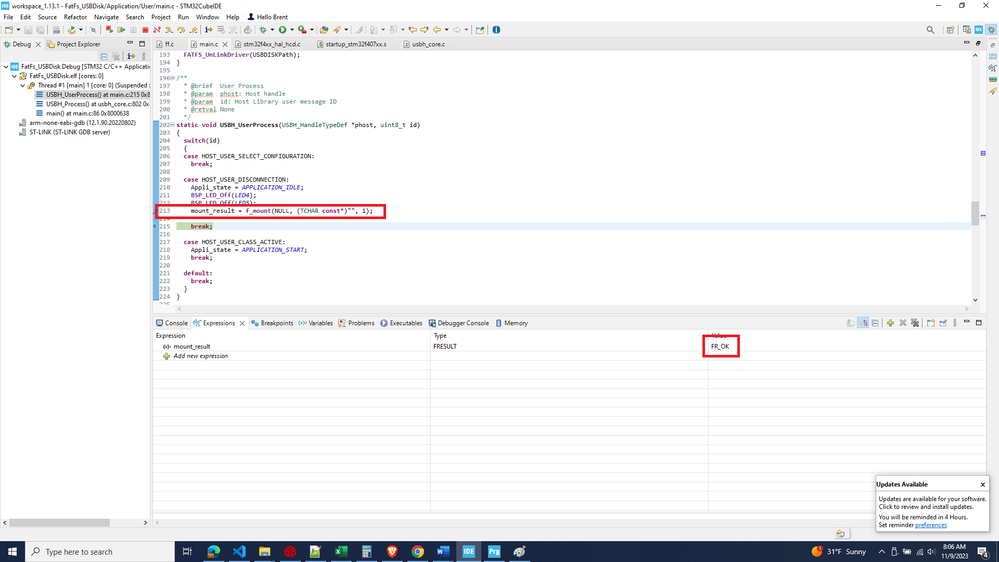

I then unplug the USB flash drive, the drive unmounts, and green LED turns off.
I then plug in the USB flash drive the second time. The f_mount() fails with FR_NO_FILESYSTEM.
I have tried different USB flash drives to see if that was the issue. I have the same issue with all of them.
Do you have this working where you are able to plug in and unplug a USB flash drive multiple times?

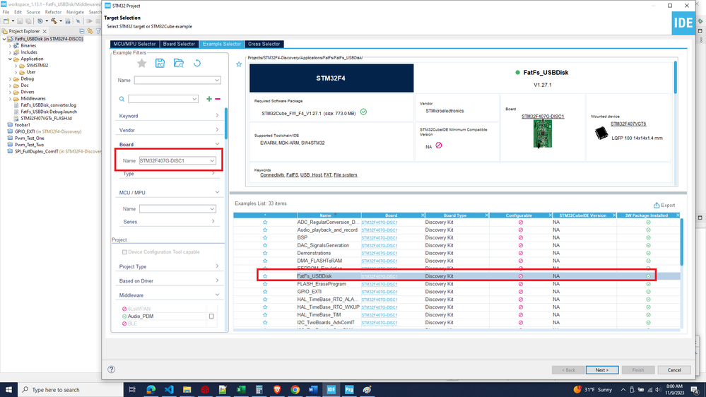

I am trying the FatFs_USBDisk from the Example Selector for STM32F407G-DISC1 within STM32CubeIDE (see below).
Are you able to get this to work or have it working in another application?
Maybe I am not understanding how this application is suppose to work? I guess I am surprised that this example out of STMicros' SDK is not working out of the box.
