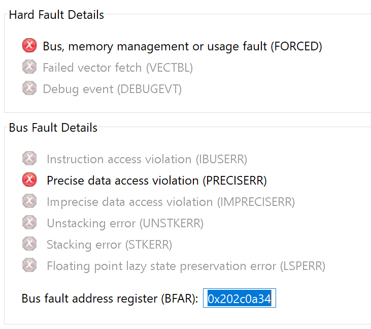

And the program runs fine for acquisition of 2 minutes, even ten of them, but when trying to log for a longer time the previously disussed errors came into the game.
I try to find some hint about Mutex implementation, but everything i found was based on RTOS, and for me it's a complete new world, since this step is something i'm doing as a step of a more long and complex project which is supposed to use the data i can retrieve.
  • Is correct the way i implemented the double buffering or i must rearrange it to work with pointers logic?
  • Is there anyway i can implement a software mutex without using RTOS?
Thank you
GDall.387
Furthermore, analyzing the hard fault, i get :
