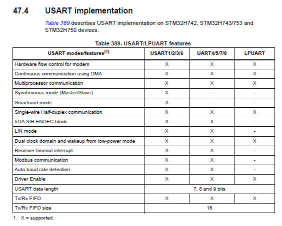

Tilen MAJERLE
Differences between UART and USART hardware IP are described in reference manual, see snapshot:0690X00000AQst7QAD.png
USART has additional option to support synchronous communication with clock generation.
You can use HAL UART module for all UART or USARTs when these are NOT used in synchronous mode. Otherwise, you need to use HAL USART module.
So for you, unless you use synchronous mode [with clock], you can use HAL UART module with all 8 U[S]ARTs in the project. All have option for HW flow control.
Hope it is clear.
