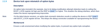

‎2024-04-09 1:56 AM
An important feature is that the source code is enabling Read Protection Level 1.
Don't do that! Changing RDP level does in fact erase the whole option byte block and then rewrites this block with the current settings from flash registers. Probably your target software is intended to increase RDP level upon first start? If this start happens right after flashing the firmware, any glitch (power supply, NRST line, ...) at that time may cause invalid/unwanted option bytes setting. Errata sheet, 2.2.11, says that lockup should not occur anymore on rev. "Y", but there are probably more ways an improper setting might cause trouble.
So either let the programmer do the RDP level change, or let the programmer start the firmware which reprograms the option bytes and does an option byte load, and wait for confirmation of successful completion before disconnecting the programmer.

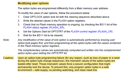

‎2024-04-09 8:49 AM
Thanks Andreas, I've just found this information at STM32G031 Reference Manual:
Just one question, which Errata are you referring to exactly?
‎2024-04-09 9:11 AM
ES0487 - Rev 6 - September 2023, 2.2.9
‎2024-04-09 9:14 AM
Thank's!
I've just found at ES0418 from STM32G031:
This is the real problem that has benn occurred...
