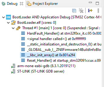

When I now step over the jump, I land in code which the bootloader debugging session knows no source for. Looking at the application's .map file, I see it is the application's hardfault handler now instead of the bootloader's. Whee, that's progress! Lol.
Unfortunately, the Cortex M0 apparently has no fault status register.
How would I find out what the MCU is objecting to?
EDIT:
Okay, a little update: after setting up source level debugging when jumping from loader to app in the IDE, I can see something readable in the call stack display. Looks like some of the reset handler variable init stuff is going wrong for some reason.
Need to dig into that.
I'm slightly confused why I get there instantly. I had instruction level stepping on already, and when executing the blx instruction to jump to the app, I immediately get this image above - no stepping through the reset handler assembly file.

D'OH! Talk about "shoot yourself in the foot AND reuse the bullet".
The call right before the "signal handler called" entry, "_static_initialization_and_destruction_0()" - it shows me a global const struct instance being initialized with all constexpr stuff (c++ file). It was supposed to be done all at compile time.
I annotated that global struct instance with __attribute__((__section__(".buildinfo"))), to, in the linker script, fix the address offset of that struct so my external tool can fetch some info about the binary.
But one of the assignments in the struct initialization, albeit a constexpr function, was apparently really being compiled as static, sothe whole thing went to static i.e. compile-time initialization, which is not quite commensurate with fixed linker section address I guess. Argh!
When I replace that one line of all the lines of struct member initialization, it jumps to the bootloader and it runs.
There's something else unexpected in app behavior, or i'm just still confused right now, but it basically runs.
Now I need to find out why the heck that assignment code line is not really compile-time. (also, I would have liked a warning about that instead of extra surprize edition binary ^^)
