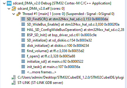

I'm using STM32F4 Discovery board and its expansion board for SD-card interfacing. I'm using SD-cards with DMA2 and STM32CUBEIDE FW_F4 V1.24.2
Before pointing out error I want to attach below link as a reference which I've used in my code -
https://community.st.com/s/feed/0D50X00009bMM8bSAG?t=1598702550733
I tried to interface a SDcard but at f_open instruction system goes to SD_FindSCR() function in stm32f4xx_hal_sd.c and stuck there in a infinite loop.
The image for my stack is as below:
My initialization code is as follows:
