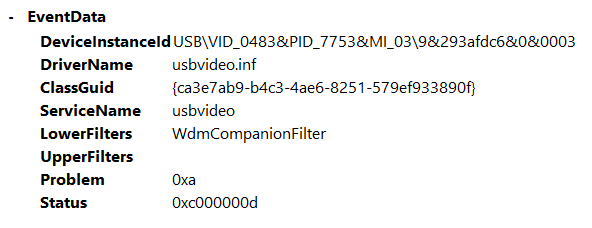

Windows is still complaining, that the camera cannot be started.
It complains about a wrong parameter being transmitted
Code 0x0A Status 0xC000000D
Do you have an idea, what the problem might be?

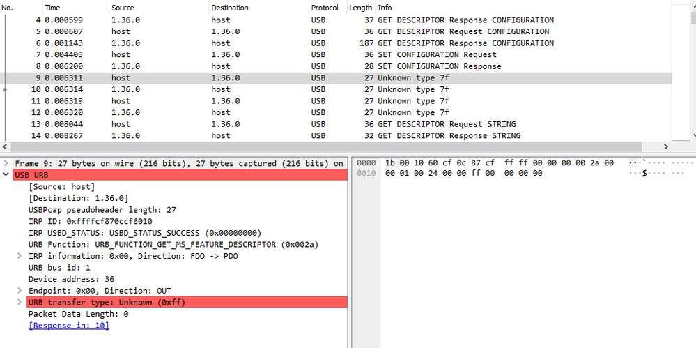

Good news: I was able to make the USB Device Video example run.
But I needed to strip my demo code down to a single endpoint USB device.
Strangely: If the device endpoint address is less than 0x83 for video, the camera app on windows does not show the video, just a black screen.
If the endpoint is 0x83 or higher, The camera app shows the demo video.
As soon as I make the device a compound device by adding MSC storage, windows is complaining about the wrong parameter for the USB camera.

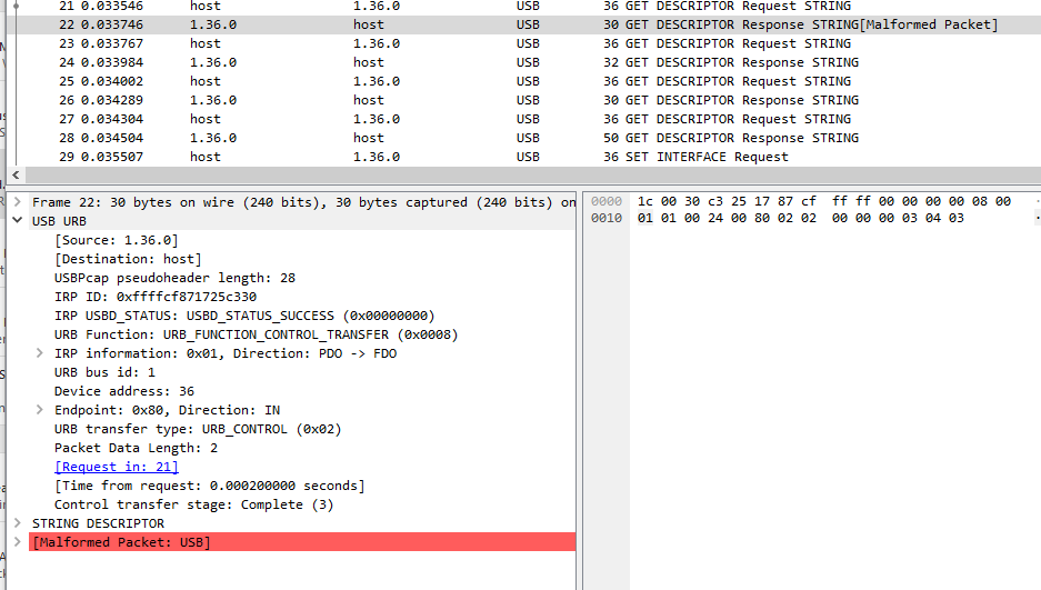

I have a wireshark USB trace. There are multiple strange packets:
_legacyfs_online_stmicro_images_0693W00000bjxw7QAA.pngAnd a malformed packet
_legacyfs_online_stmicro_images_0693W00000bjxwCQAQ.pngThe rest of the packets are related to MSC storage, i think

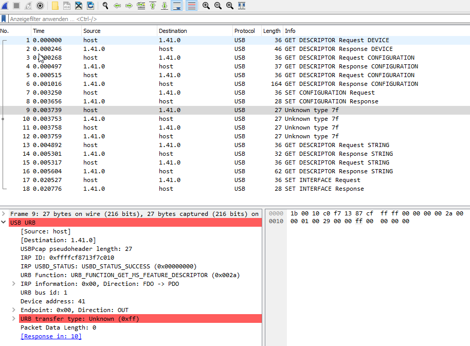

This is a trace of a working camera (singular endpoint device)
_legacyfs_online_stmicro_images_0693W00000bjy3mQAA.pngThe "unknown frames" are still there, but there is no "malformed package".
mohamed.ayed
@Johannes​ if you modifie device descriptor you need to modifie PID (Product ID)
Johannes
Senior
@mohamed.ayed​ Change the PID to what?
If I change the PID from e.g. 0x5710 to 0x5711, windows re-installes the drivers. But the malformed package is still there.

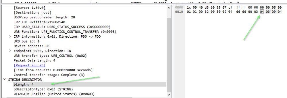

If a package is "ok", this seems to be the position is the lengh information of the payload
_legacyfs_online_stmicro_images_0693W00000bjyGDQAY.pngbLengh = 4, 1 byte "bDescriptor type" and 2 bytes payload = 4 bytes.
In the malformed package
bLength = 4, but only the bDescriptor is following and 2 bytes are missing
