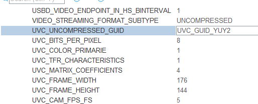

‎2023-05-31 7:38 AM - edited ‎2023-11-20 5:42 AM
Thank you mohamed. That was helpful. I was able to build my own video.
Is there an example project to use an uncompressed video stream?
CubeIDE allows for a setting "uncompressed"
is there an example for that?

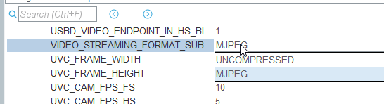

‎2023-05-31 8:13 AM
Hi Johannes,
It's mentioned in readme file
if you you open ioc of application (download https://www.st.com/en/embedded-software/x-cube-azrtos-h7.html) change VIDEO_STREAMING_FORMAT to MJPEG and change video width and height finally generate code and include stream2.h in project instead of stream1.h
- stream2 FORMAT : UNCOMPRESSED and Width = 176, Height = 144 and the descriptor shall be updated.
‎2023-05-31 11:43 PM - edited ‎2023-11-20 5:42 AM
Hello muhamad
Sorry, but I am still confused.
Stream2.h is an uncompressed stream. You say; i still should set the stream format to MJPEG?
I used MJPEG for "stream1.h" (compressed stream) This works.
For stream2.h don't I need to switch to "uncompressed"?
What about all the other parameters for the stream of "stream2.h"?
Bits per Pixel?
Format YUV2 or NV12?
Color Primaire?
TRF Characteristics?
Matrix Coefficients?
Thanky you very much for your help
Johannes
