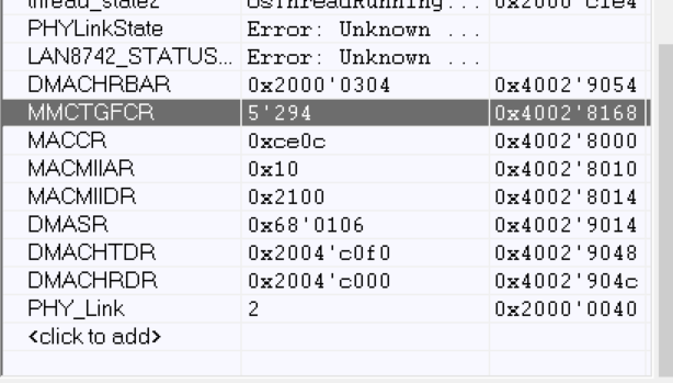

could you check the status of the link and a dump of PHY registers to check the link status after this problem occurs?
check the following regs:
MACCR, MACMIIAR, MACMIIDR, DMASR, DMACHTDR, DMACHRDR, DMACHTBAR, DMACHRBAR, MMCTGFCR

‎2024-08-05 5:45 AM - edited ‎2024-08-08 12:45 AM
Hi, @STea thank you for response,
Here, I have attached ethernetif.c file
I checked PHYLink status in stuck case it was 2. i.e.(LAN8742_STATUS_100MBITS_FULLDUPLEX)
register status in stucked state
